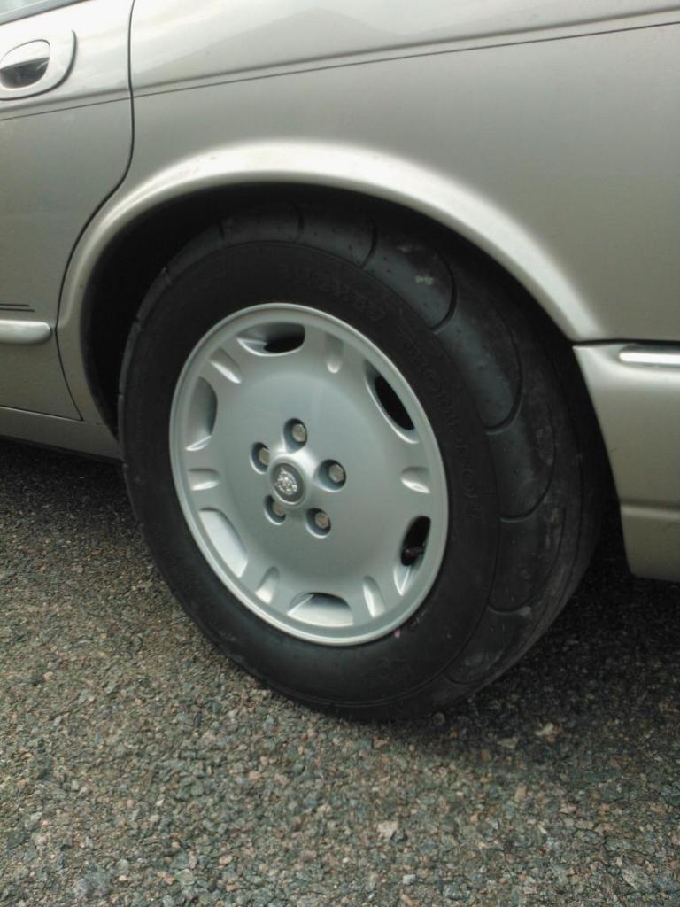

I'm guessing you'll be running slicks at the track?? If not, then drag radials must be your thing? I never could get the Nitto DR's to do very well.

MT DRs. U-joints will be checked and changed if needed.

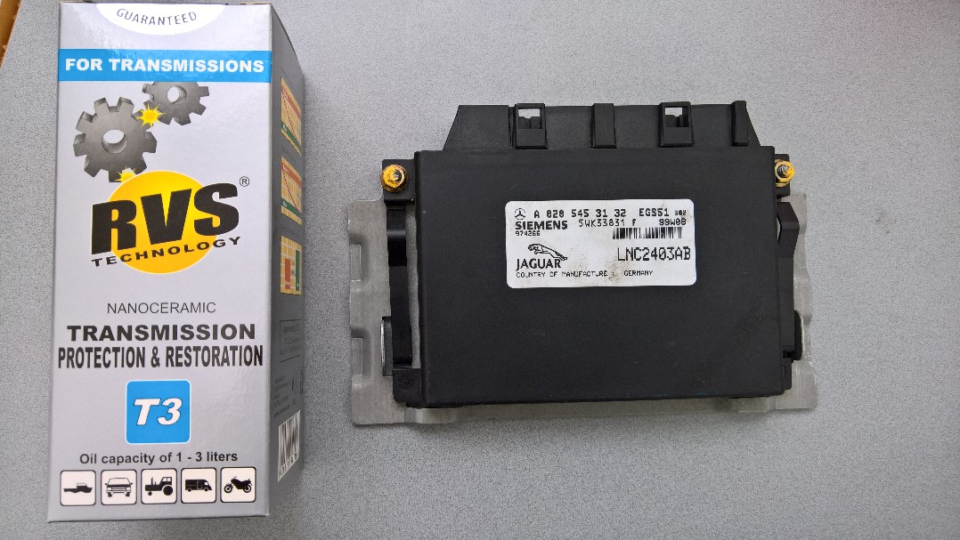

The spare TCU came back from long trip around the world. Now coded for 3.58 ratio. Diff gets new LSD oil and RVS treatment. Great stuff. Diff change early next week.

Addicted2boost's Avatar
Posts: 3,125
Likes: 1,280
Glad to see that it's all getting taken care of. You'll be happy once it's on the road soon.

No major traction problems with these:

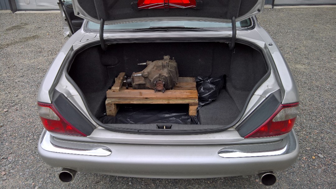

500rpm more than before when speedo shows 140km/h. The orginal diff in the trunk.

From: Australia Townsville
you need to buy a boat Sami, you have an anchor - love the tyres - what size
