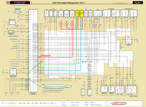

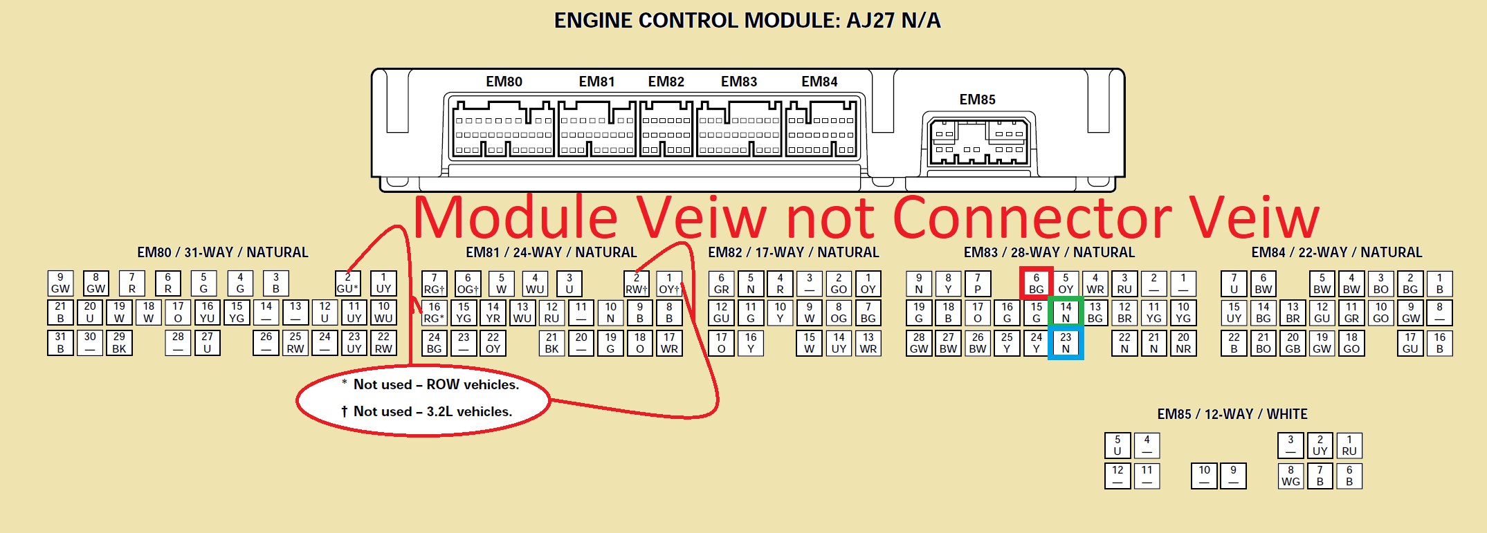

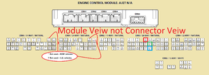

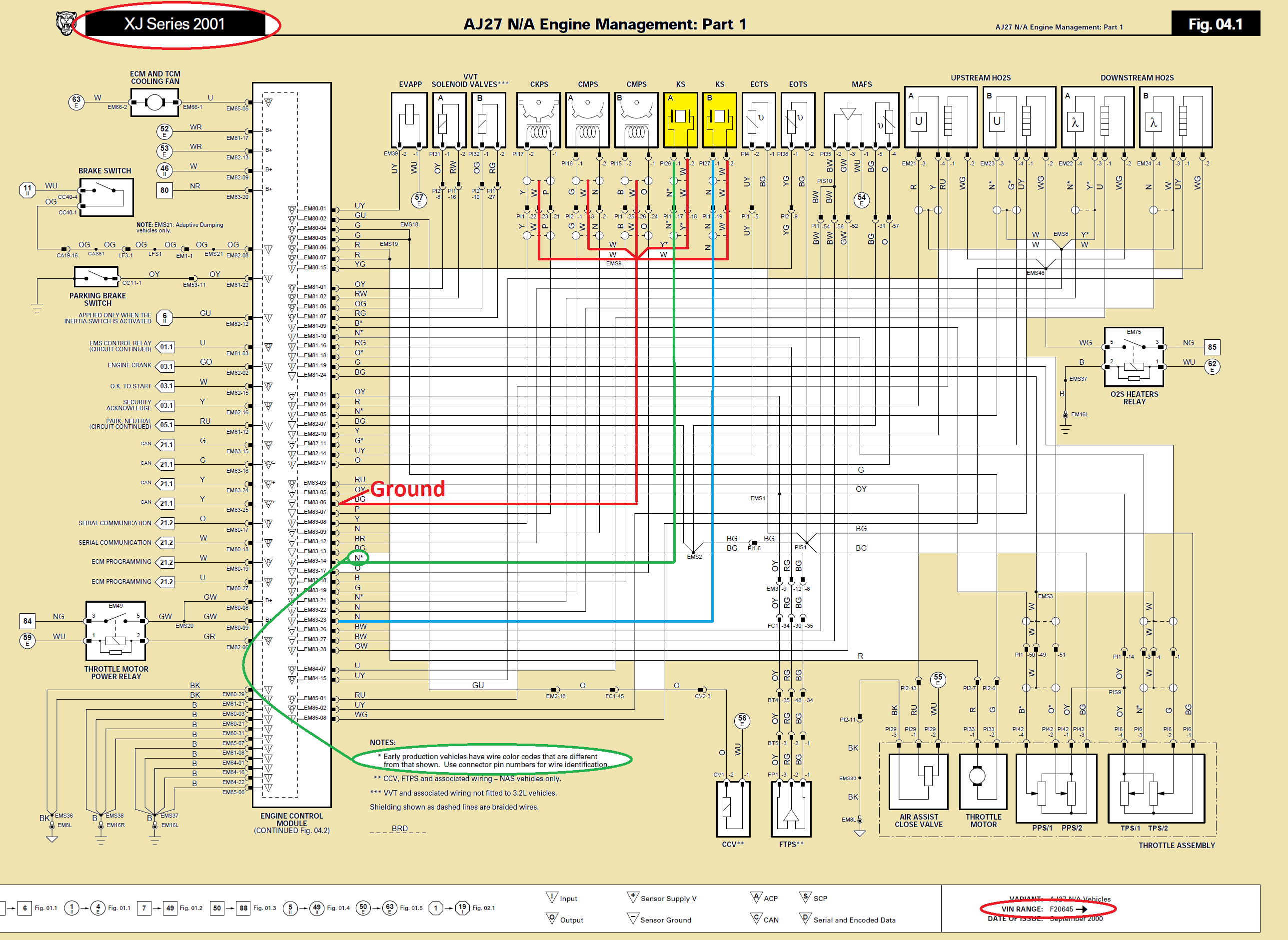

You can do the same test on car if you can tap on the sensor . This is a test that can be done both as hot and cold ,
suggest both .
You are looking at resistance at socket 6 through 14 , and 6 through 23
