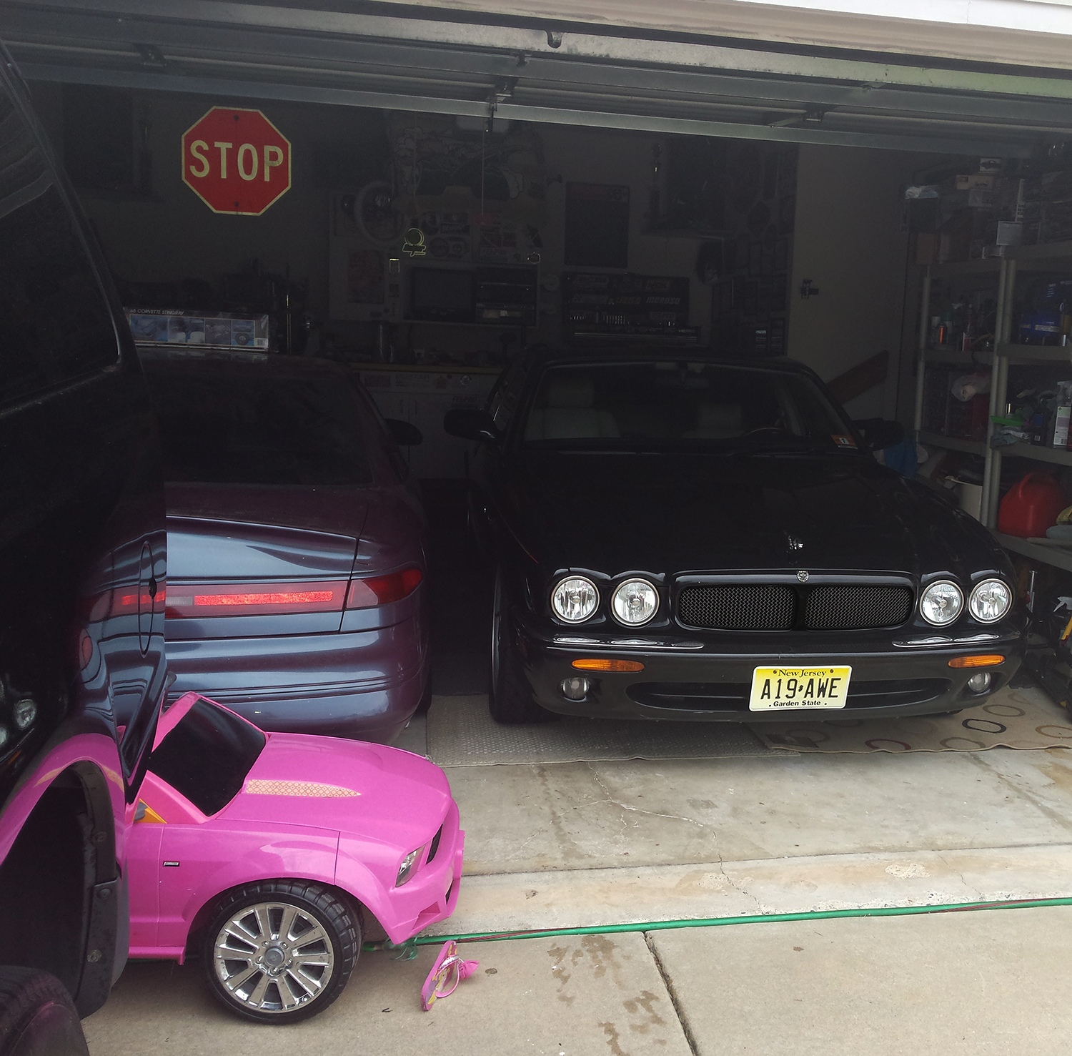

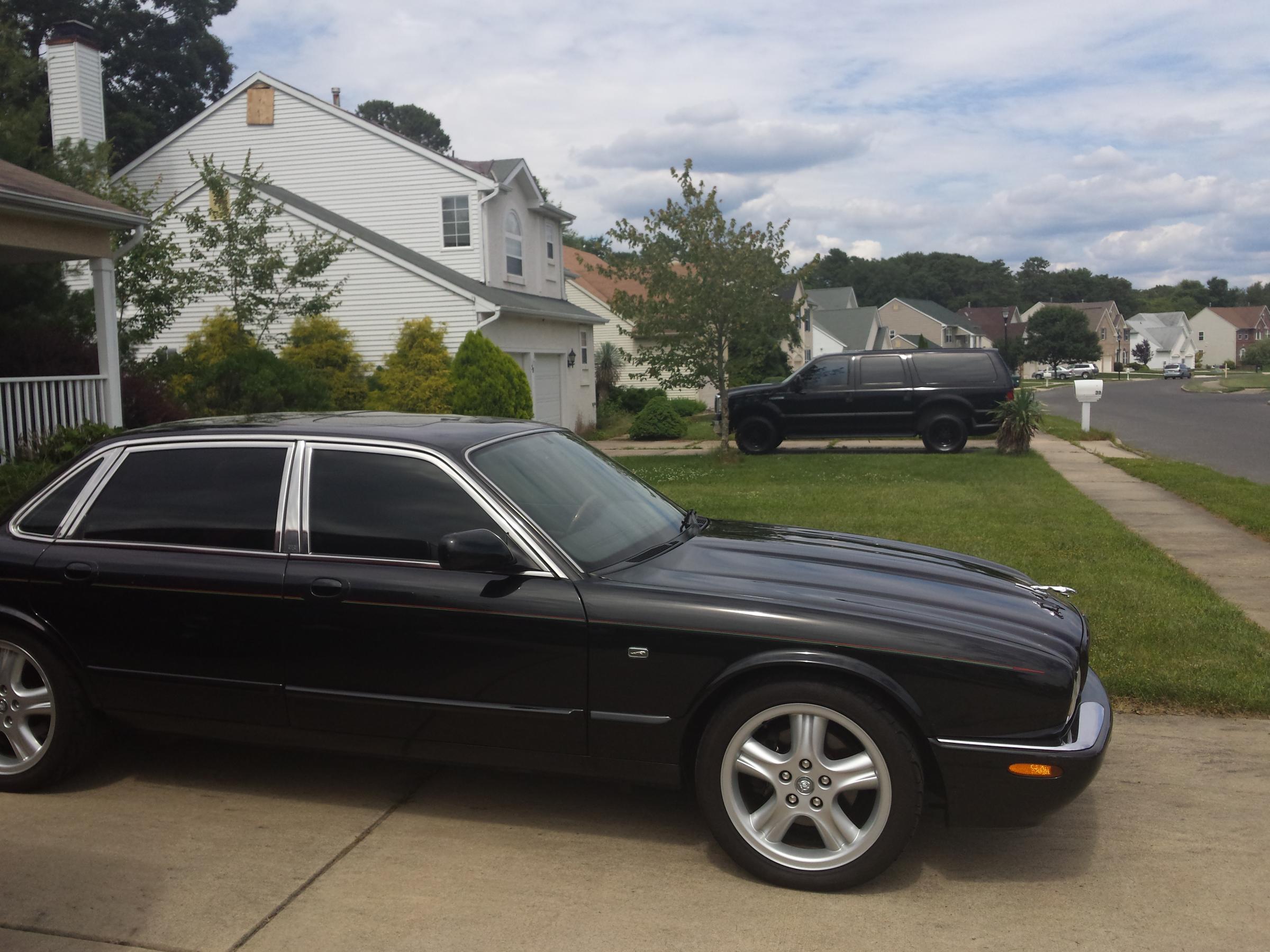

Well I finally got my Beast home. Or "Darth Vader" as my Daughter calls it,lol. Now HOPEFULLY I can get started on the electrical issues. Also I found that the tilt/tele doesn't work either. But Hey for $3200.00 for a 2 owner 98 XJR garaged from day one with a great History, non smokers and NO kids!! With a ton of paperwork and mods I will not complain.

Great-looking XJR! I wish my paint looked that good :/
My tilt/tele doesn't work either.. Again, look for a short somewhere. Most likely it'll be the wires leading to the sun visors. Also, get a 5% window strip on that windshield! It'll make it look more "uniform.."

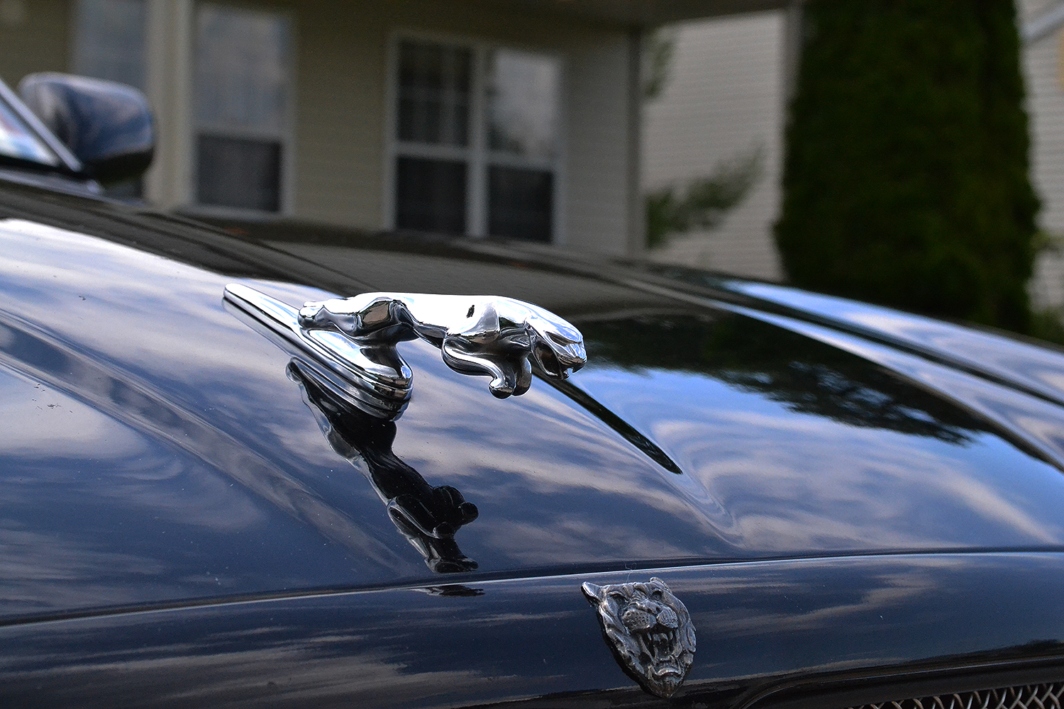

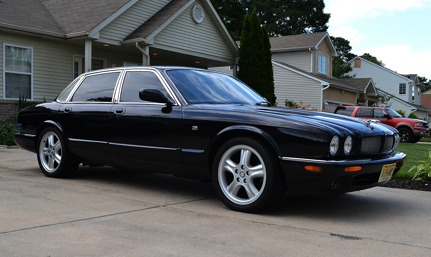

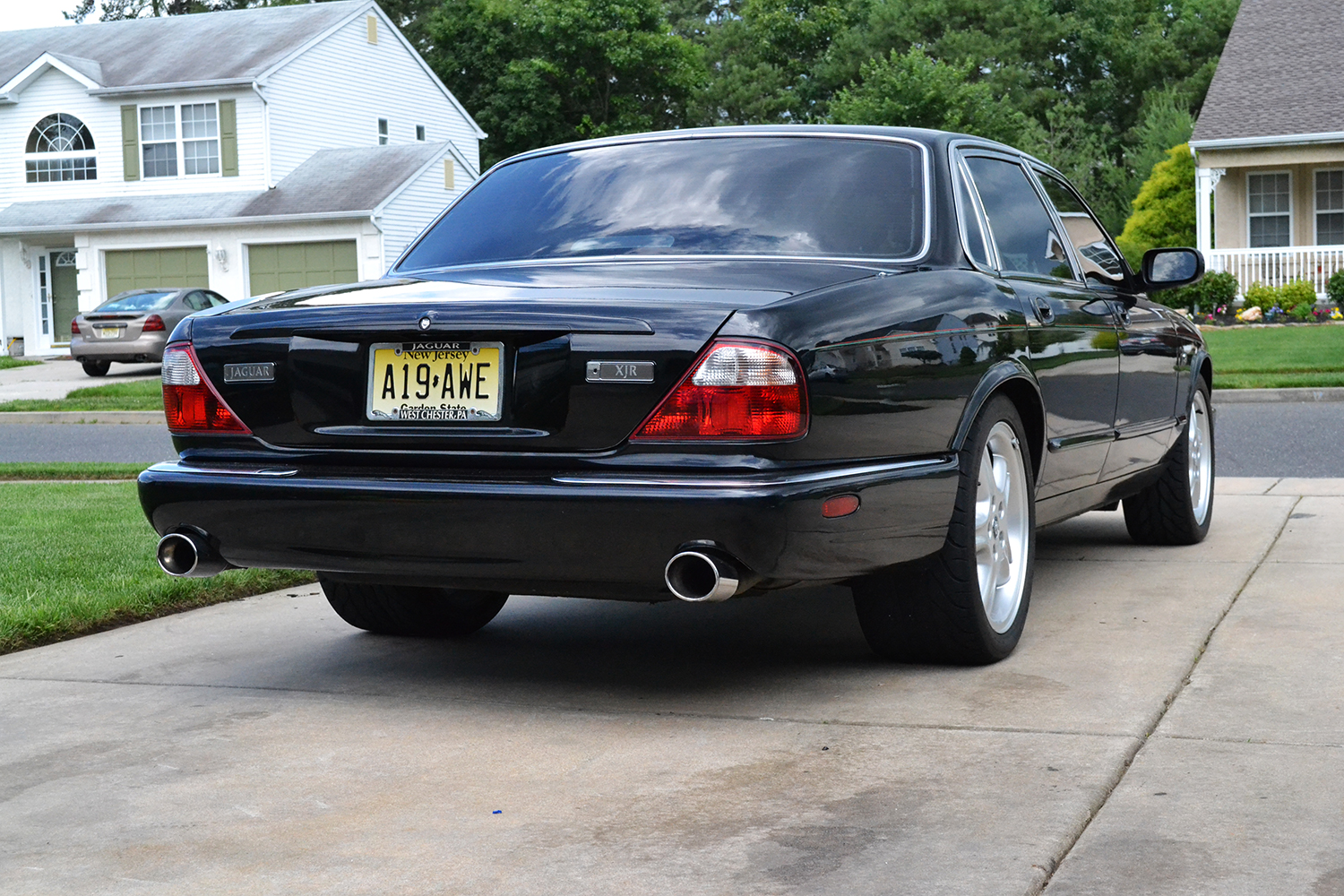

Thank You Sir. This paint after sunlight inspection shows me some serious metallic and colors in it.
Here's a couple of shots before I start the blackout treatment. Also I'll be selling the Factory Penta's which are a 10 out of 10 and look box fresh in every way, so if you Guys know anyone they have KILLER Kdw's on them too.
