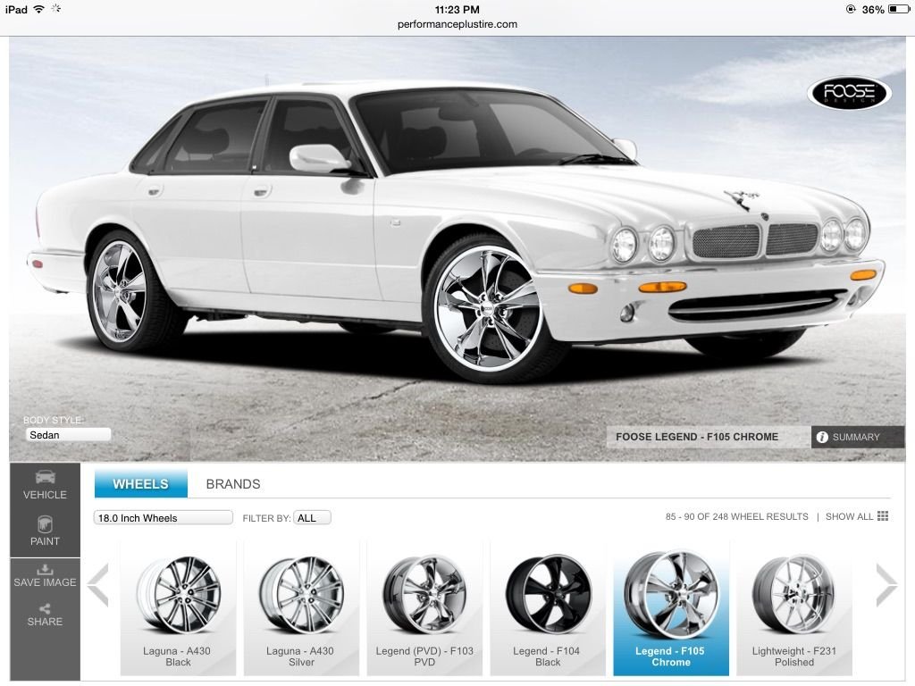

Hey guys, the xj8 is running great and treating me well. Only issue is that the Xjr wheels I bought are pretty bent and the ride is terrible. Wish I looked them over better before buying them. Anyways they would require 600 dollars in repairs, so I want to go ahead and purchase brand new wheels. It's pretty tough for our cars because I want to stay under 1k. I also want 18" because I prefer the size and would like to use the 255/40/18 tires I purchased for the Xjr wheels since they only have 3k miles.
Here is an auction for the style I like best. The offset, bolt pattern and hub size seem correct. Please let me know if you think these would not work.
18x8 5 Chrome Vision Legend 5 Wheels 5x4 75 5x4 75 32 Lifted GMC Jimmy | eBay
Here is an idea of how it would look.
I know these are typical for an American muscle car, but I prefer simple rim designs like these and I think it will look cool.
Thanks for reading and let me know what you think.

I should say they will work fine.
The offset on the standard 7J wheels are 33, these are ET32.
Should not have problems front nor rear, surely not with 255/40 tires.

Awesome. Thanks for the reply! The hub size is pretty large too. When I measured the stock Xjr rims I remember them being between 70-72. These are over 80
The original Jaguar wheels are hub centric. This is how the wheel is located
on the hub.
If you have a 80mm hub bore on a 70-72 hub, you will no longer be using
a hub centric system.
