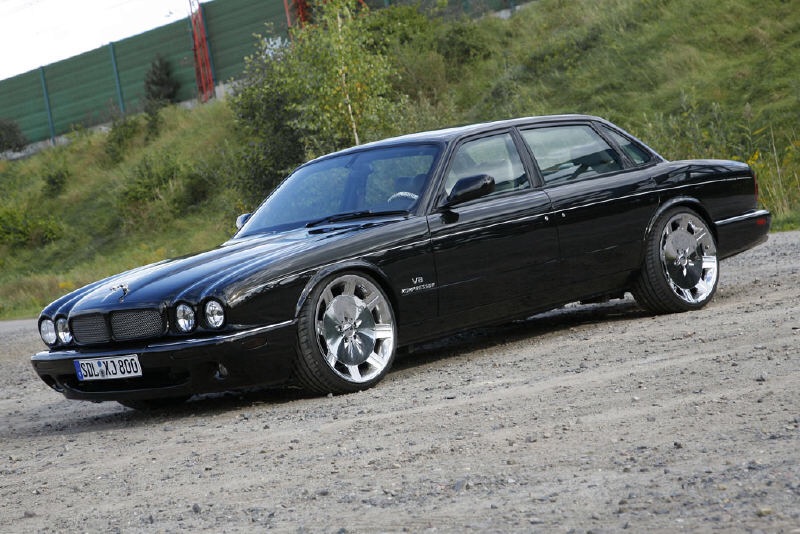

Anyone know who makes these wheels? Opinion on its looks also?

Don't know who makes them, but not my cup of tea, but then, I'm a purist.

I'm not a big fan of those wheels either - they remind me of something you'd put on a Cadillac Escalade to "pimp it out." But I'm more of a purist too, so you'll have to take that into account. My view is only 1 seven-billionth of the world's opinion...

No idea on the brand sorry, but they look like 20's, and that's not the factory ride height either
Personally, I'm not a fan of the chrome, but I do like the style. Nice big face, and bigger than stock in both diameter and width. Stock wheels are far too narrow IMHO

Opinion #4 - yuck

Those are God-awful

Far from a purist and still don't like them.
The perfect wheel would be 16x8 asteroids. Unfortunately, they are 18x8.

Nice wheels, but they're just too big for the car, like 20's?
Make the Jag look cheap.

Gianelle Mass-8
https://www.google.com/search?q=gian...w=1366&bih=696
