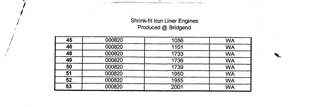

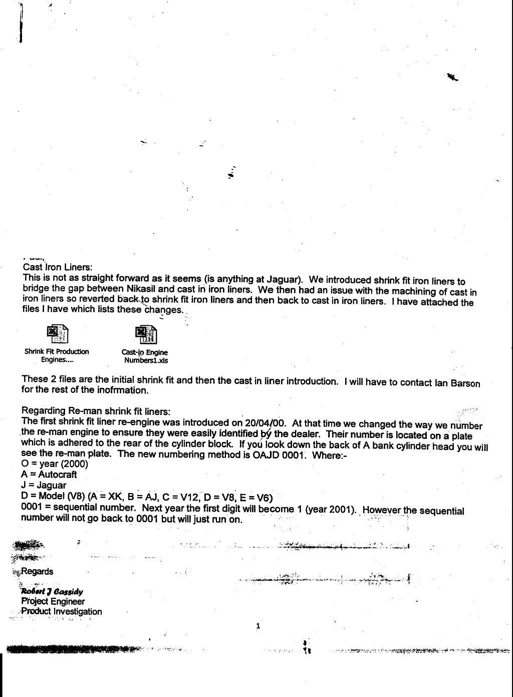

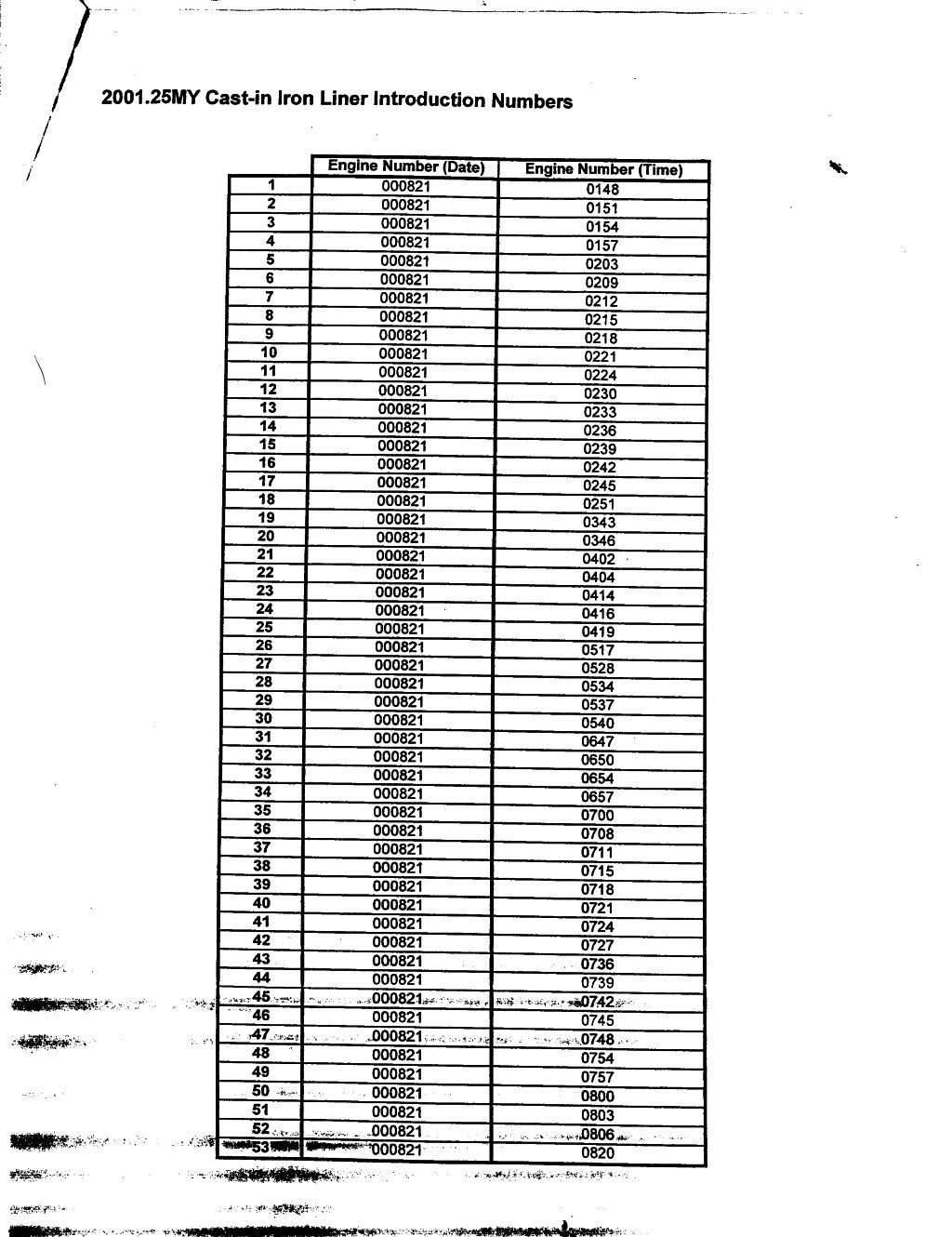

When I went to a Jaguar training session in the early 2000s (2002 or 2003?) the instructor gave us an internal memo regarding the change from Nikasil cylinder bores.
The memo discussed the 'Cast-in' vs the 'Shrink-fit' method of transition.
I made a copy of the pages given to us in a class about engines. (Engine Course 180 V8 or 168 V8/V6?)
I still have the pages in a 3 ring binder somewhere.
