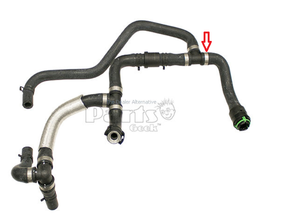

Hey n1068d.... just replaced the very same hose 'web' on my 2001. EXACTLY same leak from one of the holes (or so it appears). The NORMA connectors does appear to be locked in good. I really have zero desire to remove the whole thing and send back for 'defect'. Probably would be sent another with exact same issue. Wonder if an entire batch of these were defective.... Probably will go the route you described here. Question though: what did you use to remove the sealed 'ring' on the other end of the hose with the NORMA?

Hey n1068d, thanks for your reply and sorry if I was unclear in my question. I was referring to the fastener/ring as pointed on the picture (it's factory 'sealed'). I was planning to run a new rubber hose from that 'T' to the metal hose the Norma is supposed to hook up to. Assuming that is what you have done successfully.

OK..now I see what you are asking. I suppose you could cut the compression ring and add another hose in place of the one with the Norma fitting, but in my case. I elected to cut off the Norma fitting and use a 5 inch section of 3/4 heater hose and a 3/4 hose coupler instead. The 3/4 black hose coupler worked very nicely, and of course I used a hose clamp on the hose over the metal pipe. You don't even notice the splice unless you hunt for it. Good luck !
