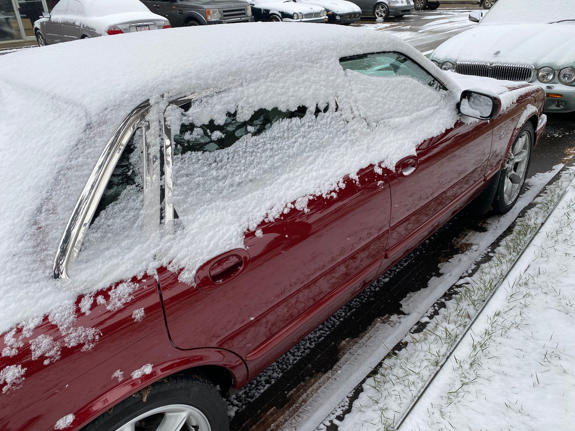

Annual pre-winter task - along with changing tires over - for those of us that actually have winter.
