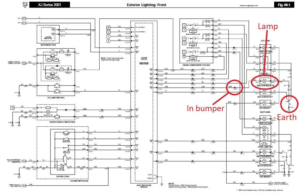

The front indicator
So giving an idea of what I have done already....
I removed the front indicator lens, and then inspected the bulb. I used a multimeter on continuity, and the bulb seems good. I them removed a good (working) bulb from the rear light cluster, and tried that; no joy. So it seems it is not the bulb... that would be too easy!
I then measured the voltage at the bulb holder. When the hazards are switched on, the centre pin is permanent 12V to earth, and the side pin is continuously changing. My multimeter is too slow to see what to; but this makes it look like things are working, and I guessed it might be a switched negative.
Out of interest, I tried all the other lamps on the car, with the exception of the brake lights. Every other light seems to work fine.
I then found the page with the lamp in the X308 electrical guide, and realised the indicator goes to a common Earth point. So I am thinking I should be seeing a permanent 0V on the negative, and a switching positive.
So I am thinking I have a dodgy earth stud somewhere or a broken -ve cable for the lamp. My gut tells me is will be a wire broken, as surely a broken earth would take out more than just this one lamp.
I managed to get my hand in under the car, to feel around and find the bumper mounted connector. It seems to be plugged in OK, but I have not removed the undertrays to check for sure.
That (after checking the battery) is probably the next thing to do...
Any other ideas would be welcome!

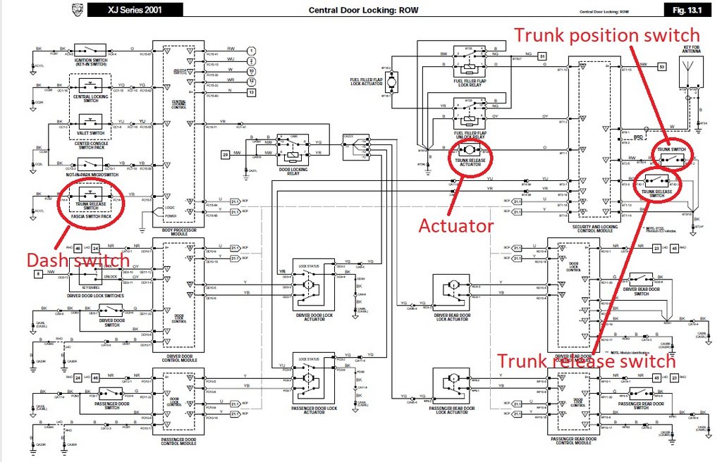

The non-opening trunk
When the easy answers did not pan out for the front indicator lamp, I decided to look into the trunk not opening on the buttons. After all it is possible they are related I guess...
So I know the trunk can be opened manually using the key, but the buttons on the key fob, dash, and bootlid do not open it. The dash also propts "trunk open" permanently, even when the trunk it closed, so the car also thinks the trunk is open, even when it is not.
The oddest thing is I cannot see why the bodyshop would have needed to go near any of this...
Out of interest, both lamps inside the trunk work fine. I did not check if they go out when I close the trunk (not that I can see how to do that without trapping myself in the trunk...
I found the relevant page in the Jaguar electrical guide.
It seems to me that as the dashboard switch, boot mounted trunk release switch, and fob button are not commonly connected, it is more likely the solenoid is the problem. I suspected the earth point, but as this is shared with the fuel filler cap solenoid (which works fine), I would say I can rule that out. So am then thinking it could be the output from the security and locking control module to the solenoid.
But the thing that sticks out in my mind of particularly odd, is why there is a warning on the dashboard that the trunk it open. Why would a non-working solenoid cause a trunk switch issue??
Any ideas??

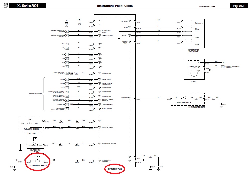

The coolant low level warning
I originally assumed I had obviously lost some coolant, and cursed the faithful Daimler. But when I got home and checked it, the level was fine. I even overfilled it to make sure.
Then I did a bit of reading, and realised the sensor is on the underside of the tank, and it would have to be very low to trigger the alarm.
I located the sensor, and all looked fine. The connector was firmly plugged in, and I could see no damage to the cable.
Then I took away the windscreen cowling, along with the under-bonnet covers, and realised the cable disappears where you cannot follow it...
I found the relevant page from the X308 electrical guide, and it appears the cables go to an earth stud, and the instrument pack (which I guess means looking behind the speedo pod.
I have not yet found the earth stud, which would be a good one to rule out.
Again... other than my current plan of action... any ideas?

Chris, you probably know I can't help much when it comes to actual work but for the interior trunk lights going out or staying on when the trunk is closed you could set your phone to video and place it in the trunk to see what it records when the trunk lid is opened/closed...

On the indicator, I wonder if it's just disconnected, that wing would need to come off to complete the strut top welding.

Boot power could be either a wear related broken wire in the trunk lid loom, or fuse.
