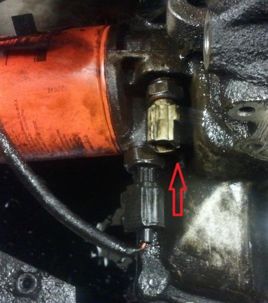

I have 2 connectors on the oil filter mount 1 is connected 1 is not.
I cannot find another plug on the loom, does anyone have an idea what the connector is for?

It is the oil temperature sender. It lets the ECM know when the oil is warm enough to use the VVT system. It is not present on SC engines.
The other is the oil pressure switch present on NA AND SC.

Thanks Plums. I was going crazy trying to find the wire connector.

Shouldn't it be a plug (not a sender) on an original XJR motor?
I am guessing here, not asserting.

was wondering the same thing.

me too. if all is as Jaguar planned, this is another difference between an XJR and N/A cars
Different wiring loom on engine

I can look under my car if anyone is interested.

Sure .. I even clicked the thanks button. Please note if the blank spot is a plug, of what type, or not machined at all

Interesting... Looks like mine also has a second sensor, but with a blank connector. Maybe so when one dies you can just move the plug? lol.
