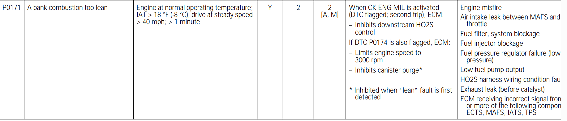

I'm getting P0171 and P0174 and restricted performance. It happens only on start up and last for about a mile or two. I know this means lean on both banks. My understanding is that the fuel injection is on open loop until the engine warms up. I this means that any output from the 02 sensors does not mater when on open loop. Any ideas?

With your OBD reader in data mode, read the air temperature: this sounds like the temp sensor has failed and the ECU thinks the car is still warm and is not enriching the incoming mixture for cold start.

Ran test this morning early (so sun did not heat up black car) on cold engine. Air temp 71degrees F, reading 82. As soon as cranked immediately rose to 88. When engine warm and driving 45 mph reading 15 degrees higher than ambient.
When cruising after warm, restricted performance came on a couple times for maybe 15 seconds.
Ran a smoke test and no vacuum leaks.

Had my original MAF sensor. Replaced before I figured out my prior lean burning was from an air leak. Put that one on. This one reads ambient air about 5 F under true temperature.

It was the MAF. Replaced with a new one and problem gone. Bad one only two years old. Brand Wagner.
