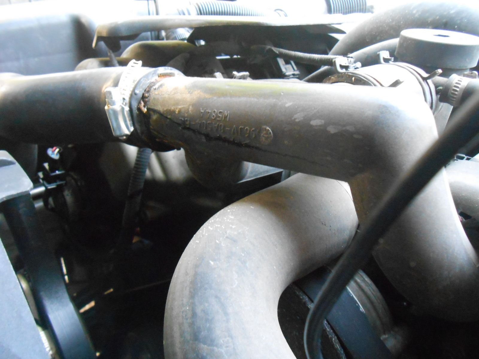

Bought a '98 XJ8L back in January, at a good price, but considering who it was purchased from, I expected to have to do some work on it.
With some invaluable guidance from this forum, I dove in. Replaced the fuel pump, cleaned out the throttle body, changed plugs and air filter (about 30K miles overdue), replaced the coolant reservoir, airflow sensor and intake, PLUS has the transmission rebuilt. Now, another minor issue has cropped up: a leak in the cooling system.

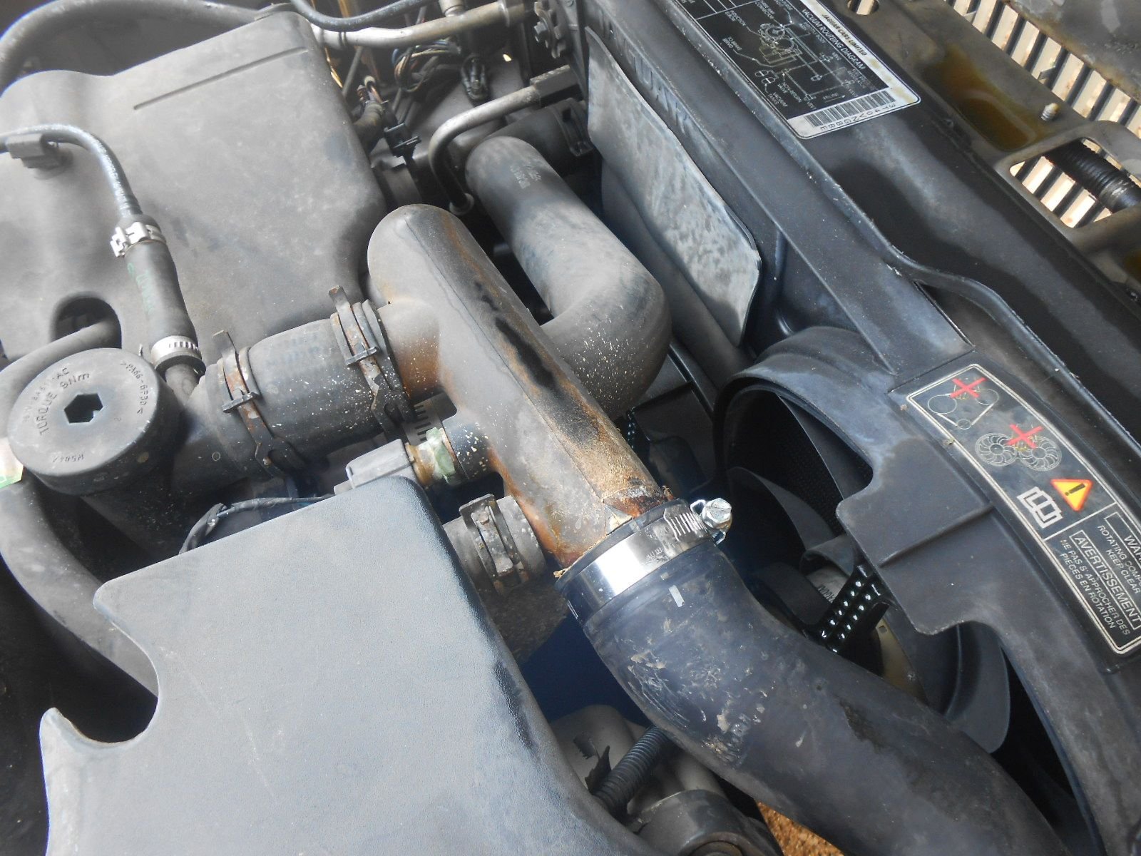

You can see the crack where the hose connects. Question: can someone ID this part so I can try to locate one to replace it? Thanx!

If I am understanding which part you are indicating is cracked, it looks to me like what they call the "water outlet pipe". Part number NCA2241BC
(part numbers AJ85885 AJ82216 NCA2241BB and NCA2241BC have all been ascribed to this part, but when I search any of them they bring up the same item).

That's the outlet pipe or crossover pipe AJ85885 available online from many suppliers. This is a good time to replace the thermostat housing with aluminum, also thermostat and hoses.
But more important, are the secondary chain tensioners upgraded to the metal body 3rd gen?

That seems to be it. Thanks!

As for the water outflow pipe, be careful where you buy it. I purchased mine from eBay (due to the sensor in the middle literally shooting off and spraying hot coolant in my face). I paid about $80 after shipping, they can be had for around $50. Try RockAuto or CarID.
