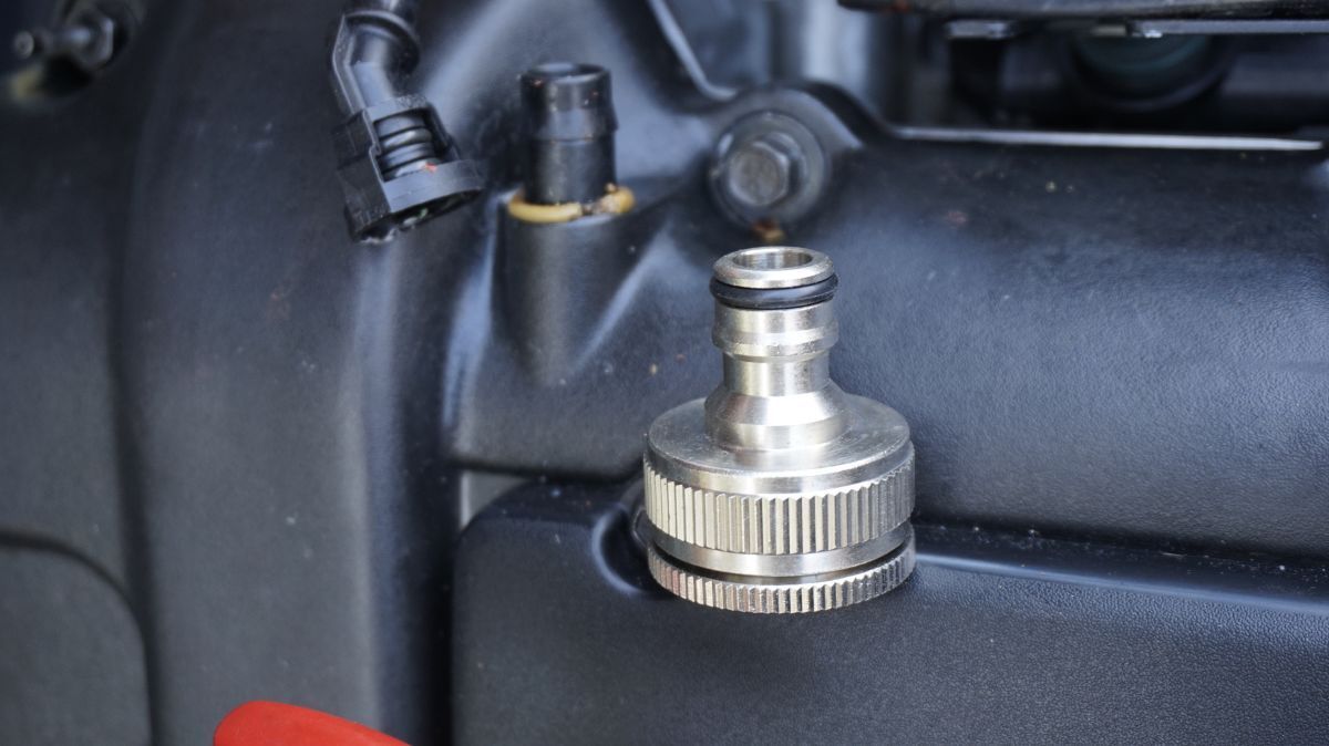

If I had the same issue, I would create my own new stub - maybe the following pic will give you ideas:
For this picture I removed the part load breather hose (either P/N AJ84880 or AJ84879 depending on which X308 you have) from the stub... - and I placed a metal water tab outlet next to it...
And? Does it give you ideas already? Somewhere along this line of thinking I would find a way to solve the problem. Obviously, you can't take the tab as it is and hammer it in the cam-cover... - It would require some modification - thinner here, thinner there, shorter there, sharper corner there, bigger ID. And after adapting it as good as possible, I would probably seal it in position on the com-cover using red-gasket maker for hot environments. Alternatively, you could obviously check, if you find metal flanges in some hardware-shop, which are more suitable. Or: If you have a lathe (or know someone with a lathe), all you need is a round metal bar and then carve your own stub...
