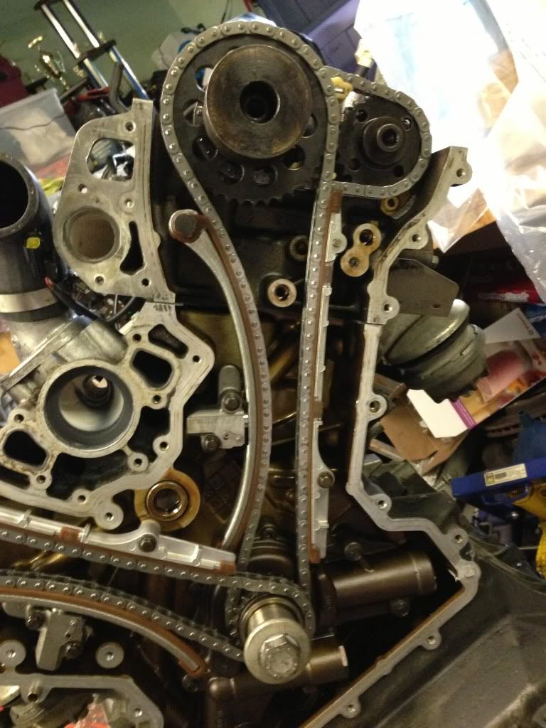

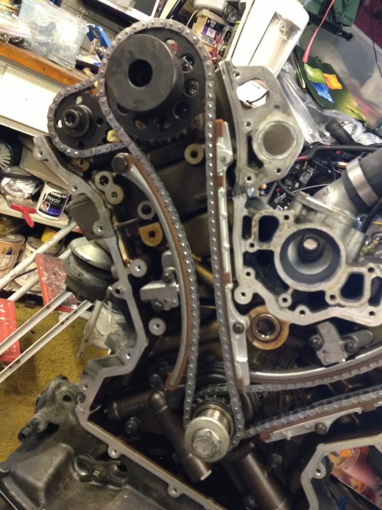

OK I see what you're talking about. Here's some pics of the bolts in my engine.

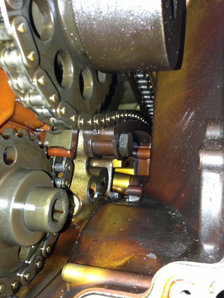

Do your bolts look like these? The first pics are with the bolts tight, and these are of course just barely started.

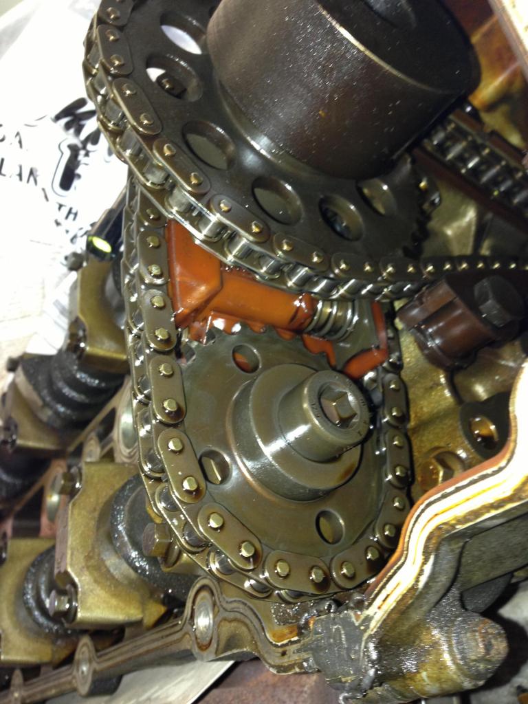

[IMG][/IMG]
[IMG][/IMG]
