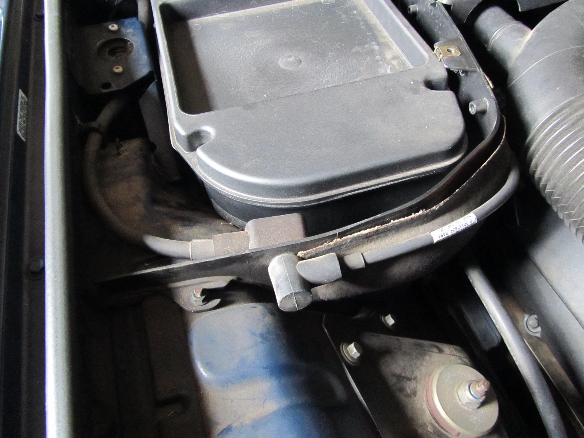

You could have opened the trunk by opening the hood and used the false bulkhead connection:
In the engine compartment on the passenger side there is a rubber cap on the false bulkhead, pull the rubber cap off the stud then put a positive jump lead on it and the negative jump lead to the chassis as a ground.
Now you will be able to open the trunk. DO NOT try to jump start the car this way.
Here are 2 photos of false bulkhead location:
Photo of the engine compartment - shows the bulkhead covers and the false bulkhead next to the passenger bulkhead cover:
