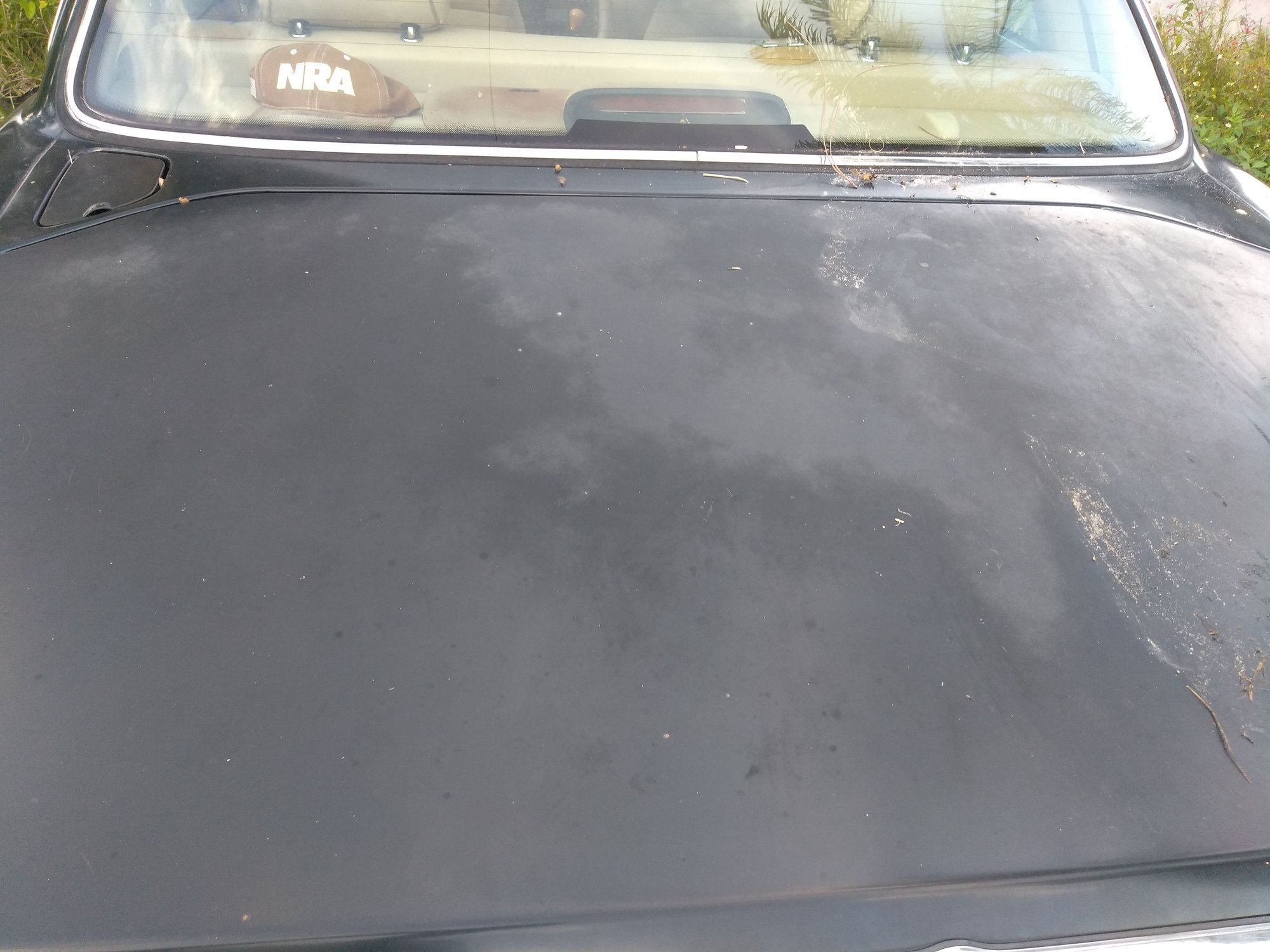

Default Clear coat is heavily oxidized.
IveI got to buy a buffer and get to work.
