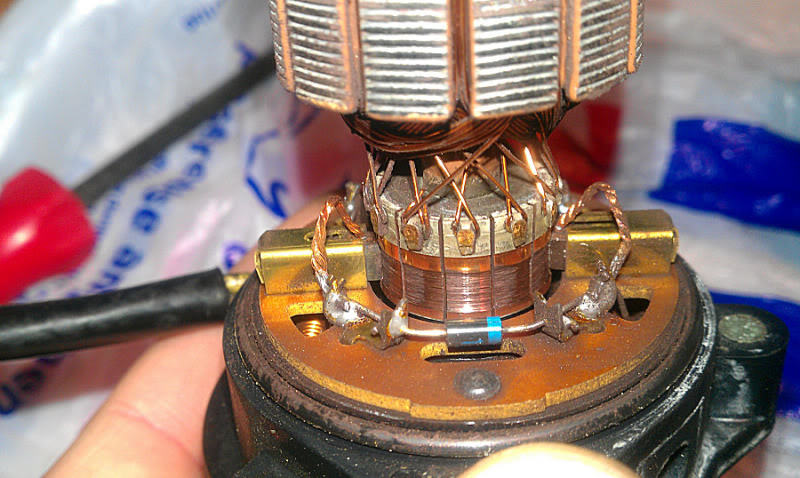

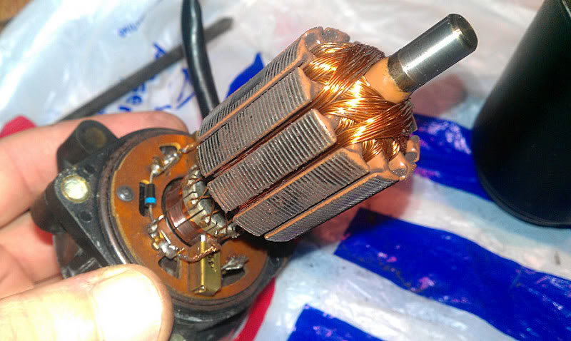

Here are the pictures of my pump when I took it apart, does it looked like it's time for a new one to you guys?

From my experience with the one from a XJ6. The brushes are worn out. A electric motor repair shop can install new brushes, but cant turn the armature because the of the way it is put together.
My repair lasted about 2 years the brushes went out again.
I found one one EBay reasonable and intalled it.
The brushes are the weak spot as this motor runs any time the car is operating heat or not.
They are expensive new.
Good Luck.

I am definately going to buy a new pump now (recon one) because when I took the expansion tank filler cap off, the water was just sitting there with the engine running, ... The water wasn't moving!! It should have been like a whirlpool in there!!

Looking closely at the picture I took of the brushes, look how worn down the one on the ''left'' is, ... Definately a gonna Sean ;-)
