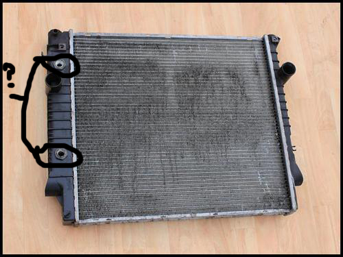

the pipes I'm confused with are these two circled to the left:
if they are for the AC how do you swap the rad without depressurising the system? unless they are for something else? haven't taken the existing rad out yet so might become clear then!

Old May 14, 2013 | 05:57 PM
plums's Avatar
Posts: 9,733
Likes: 2,201
From: on-the-edge
transmission cooler
Old May 14, 2013 | 06:51 PM
John Tarantula's Avatar
Posts: 39
From: London, UK
ah splendid! that saves me a lot of headache, thank you!

From: atlanta ga
yep, and blow them out pretty good, maybe even flush them is they have been open for ag while.
