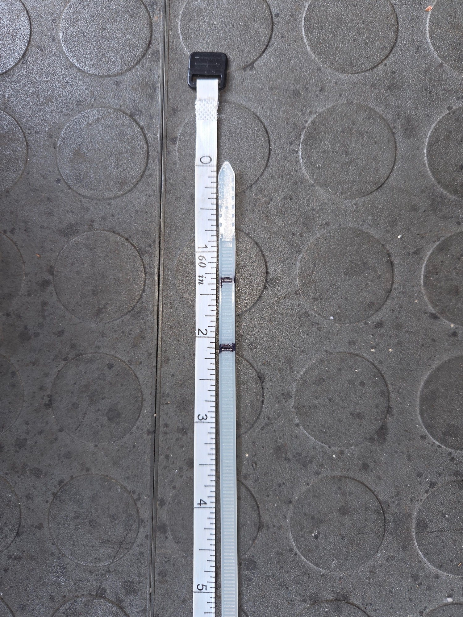

Be aware; some of the new replacements at $900 and up plus ground shipping
have transmission tanks that are not deep enough for factory transmission line fittings. The metal fittings bottom out and don’t allow fluid to flow through the radiator to cool properly. You can see the depth difference in my crude measuring stick.
The supplier made good on refunding my money and shipping. The radiator order was confirmed with my vin and this is the original radiator and transmission lines. These cars are worth the extra expense, trouble and headaches but it can be frustrating. Scott
Now that you say, I remember the transmission lines not fitting to the end.
Which radiator is supposed to be used? There were no more options I believe.
