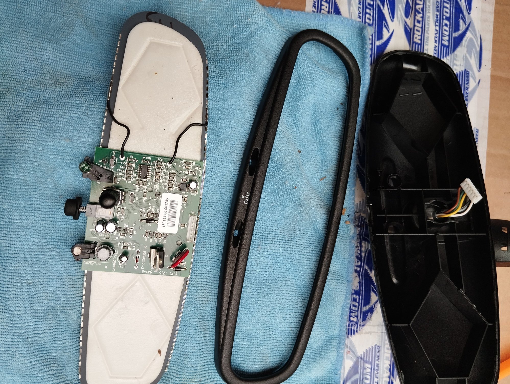

Hello
I have a 1999 x308, and despite a new Donnelly dimming rear view mirror being installed 10 years ago, it has failed again .
I have taken it apart , with the aim of seperating the .mirror and glass to drain the electrochromic fluid and just have a plain mirror . The electronics should still allow the auto headlights etc to work. However the 2 pieces of glass seem to be super glued on. Even a razor blade and heat won't budge the 2 pieces of glass.
Has anyone used an aftermarket Auto dimming mirror and wired it up successfully.? What have other people done in this situation....I know there is a firm in Holland who rebuilds them, but I'd rather not.
Regards
Peter

Hi osyris,
The leaking auto-dimming mirrors can usually be repaired. Two companies I have used are:
Radar Mirror - Auto Dimming Mirror Repair
Sybsema's Electronics - Auto Dimming Mirror Repair
Prices may have increased, but the last mirror I had repaired by Radar cost about $100 plus shipping, and turnaround was about a week or so.

I used Radar Mirror. Very satisfied.

Default Mirror Repaired 3rd Time!
My broken mirror was delivered Saturday, 8-23-2025.
On F, 8-22-2025, I saw the USPS tracking estimated delivery for Saturday & was concerned that the business is probably closed. I wondered if USPS would consider it undeliverable & return it to me. I emailed Scott at Radar Mirror re this but got no reply.
I got tracking info saying left at front door/porch which made it seem like a private home delivery. I Googled the address & it was a home.
I was concerned that somehow I sent it to the wrong address but double checking the instructions from radar mirror… That was the correct address! I thought maybe it's a home business.
Finally Wednesday, PM 8-27-2025, I called the phone number & was able to speak with Scott who confirmed that he did receive my package but had not opened it yet. I was relieved that he received the pkg.
Same day PM I received an email from Radar Mirror/Scott: “Your mirror housing is cracked from it being opened previously. Opening it again may make it worse. I will do the best I can with it. “
Now I was worried he’d say cannot repair it. He also sent photos of my mirror showing some small cracks on the housing that I never noticed. (This is the 3rd repair from the 3rd company…as I posted earlier)
Next day, 8-28-2025, I got a shipping/tracking email from Radar Mirror.
I did not know if it had been repaired or if due to cracks was just being sent back to me. The time between his email telling me about the cracks & the shipping notice seemed too short for him to have repaired it.
8-28-25, 5:07 PM email re cracks & telling me not sure can repair.
8-28-25, 5:19 PM shipping email.
Only 12 minutes to repair it and trigger a shipping email?
I emailed Scott to ask if it had been repaired.
YES! He replaced the cell & it should not go bad again.
I was very relieved!
I watched the UPS tracking updates & finally it was delivered 9-5-2025.
I can see the glued(?) repair of crack at top & looks OK . Will not be noticeable. Glass looks good w/o the spiderweb pattern.
I reinstalled (With much difficulty) same day.
Main issue, as b4, was the main attachment to windshield is not tight enough. I tried blue thread locker on the clips that slide onto that metal rectangle that is attached to the Windshield. No help. It fell off as I worked on the wire harness connection in the center console.
Dropping the Roof CC is somewhat easy, need flashlight to see the plastic screw in the sunglasses case, in order to turn it 90˚ w/o stripping the plastic screw (even in daylight). That drops the back end, closest to you in the driver seat, at an angle. But I needed to unclip the front large 2 clips & they were difficult to put back into place. The one closest top passenger side kept coming out of the roof metal slot! I finally used tape to hold it in place as I worked the CC so both front clips went through the slots in the CC.
Mostly working by feel, but also using a flashlight and peering into the approximate 1 inch gap, when I had CC almost in place so I could see that that troublesome passenger side clip was in the right spot, as I worked it to get the driver side clip in the right spot. Once the Plastic screw (I only dropped it 1x LOL) was secured I turned to the difficult task of getting the mirror attached to windshield, w/o wobbling & then dealing with the brittle plastics.I had previously used TESA cloth tape with Heat resistance & used that again.
Tesa 51035 High Performance PET Cloth Automobile Wire Harness Tape
Some of my plastics which are quite broken are only held in place with this tape!
I had it looking good, but it was still wobbling so I removed the tape, removed the plastics and I did what I think I had done years ago with different tape.
I finally took the mirror off the windshield again and put two pieces of cloth tape on the right and left of the metal rectangle on the windshield in order to give the clips something thicker to grab onto!
The mirror seems to hold much better and I still used a thin strip of cloth tape on either side b4 I reinstall the plastic (again securing with thin strips of cloth tape.)
Years ago, I tried w/o success, to source a replacement clip so I could attempt to use pliers to bend my existing clips so they would hold the windshield tabs much tighter. My concern was breaking the clip & not having a replacement!
Note: I also secured the rain sensor disc to the glass with some cloth tape, since it has lost adhesive ability long ago. If it is not tightly attached to the window glass I do not think the rain sensing will work. It never worked well since when wipers set to auto/rain sensing, they wipe if you go over a bump or tap the mirror!
I remember noticing this problem during my initial 4 yr. warranty. And having Jaguar replace the sensor at least once without any help at all. So, I made them show me a new XJ8 and the salesman demonstrated that with the wiper set to auto… If he tapped the mirror they would wipe… LOL !
I pushed the bottom auto button on the mirror & the green LED lights up.
I test drove & with car headlights behind me I see no difference with that Auto button on or off!
So, I very much doubt that the automatic headlight dimming function works! I do not know if it ever worked or if after the first or second or this third repair it was broken.
At least leaving headlight stalk on AUTO seems to still work.
My total cost including shipping to Radar Mirror = $150.75. I consider it worth it even w/o the auto dimming feature.
I sure hope this is the final time I ever have to remove & reinstall this mirror!
