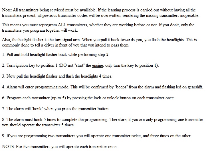

I reprogrammed our key fobs using the instructions provided in one of this forum threads.
Here is a jpeg of the fob programming information (click on the image to enlarge it):
If you have more than 1 fob to reprogram, then headlamp flash twice one first fob, headlamp flash three times on second fob, etc.
