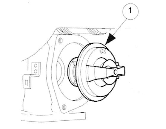

I have a 2000 XJR that I replaced the thermostat on but i think I may have placed the thermostat wrongly. I need help with the placement of the hole in the thermostat...should the hole be in the top or bottom when I insert the thermostat into the housing?

This is a very old thread you posted to but as it's a straightforward question, here you go:
The hole always goes at the top to allow air to bleed. This drawing is the N/A but the S/C engine Thermostat fits exactly the same way up.
