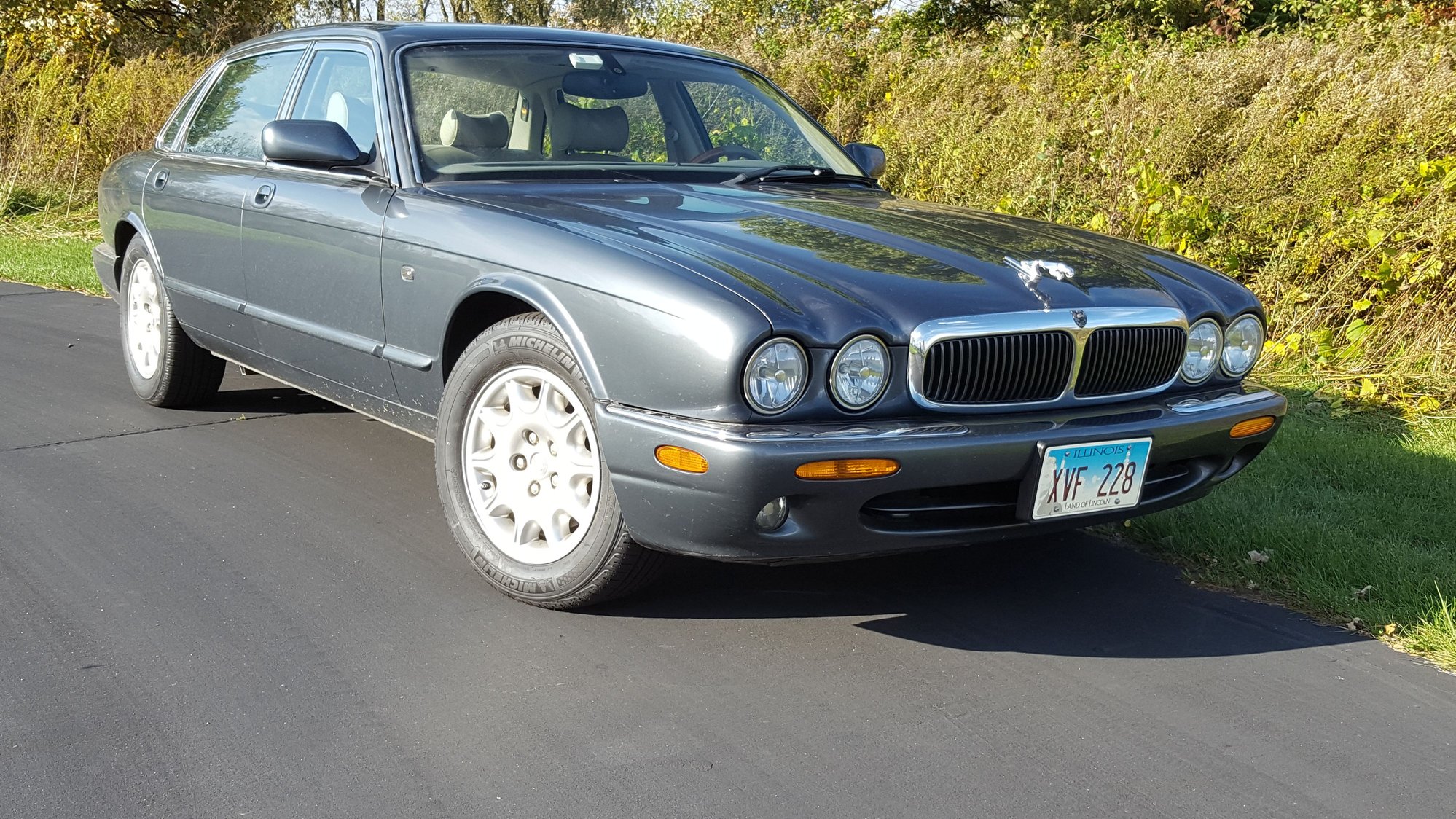

It's on the road! Put new tires on it Sunday, and have put about 200 miles on it since. The only issue that has cropped up so far is a P0443 code after I filled her up with gas. I didn't overfill, so I know it's not the common 'too-much-gas' situation. I haven't checked the 2 larger hoses going to the valve yet, but the small vacuum line is new. If the hoses are tight, I'll probably just buy a new valve and be done with it. Other than that, I'm really enjoying driving it. These are wonderful automobiles........ (seems to sell it short to merely call it a car...)
I stopped by a local park on the way home today and took this pic. I haven't even really cleaned it yet, let alone detailed it as it deserves, but here it is:
Been rainy since Sunday, so it's not "Beauty-shot" clean but I'm lovin' having it not be in the driveway on jackstands...
