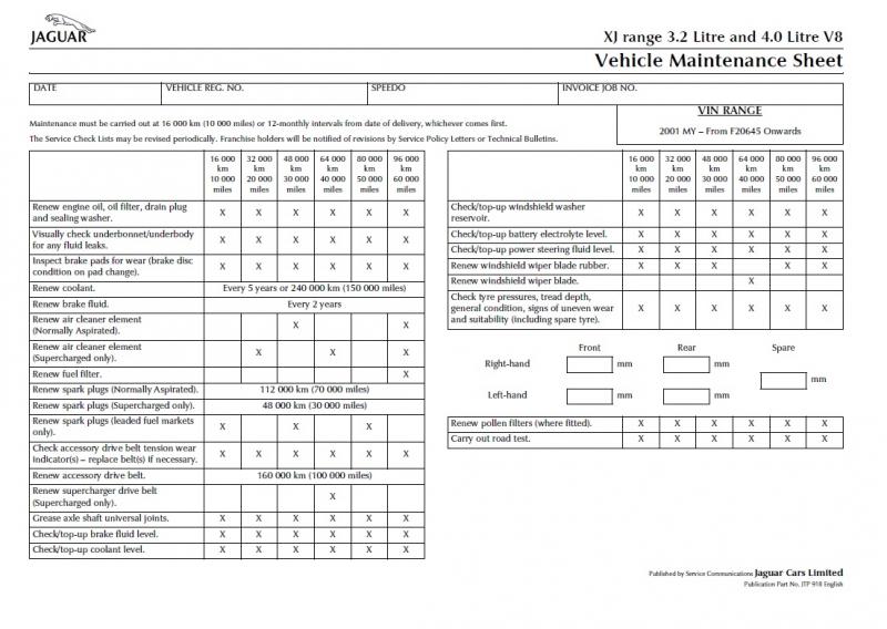

Old Oct 4, 2012 | 04:30 AM
Likes: 17,008
Here's the Jaguar Maintenance schedule to 60k miles:
The sequence repeats after that so at 100k miles, the 40k service items should be covered.
Over and above scheduled maintenance, check the HOW TO section at the top of the threads here for advice and information on Tensioners and Transmission fluid changes.
Attached Thumbnails Rust on Ignition Coils & Maintenance at 100k-xj8-2001-maintenance-schedule.jpg
