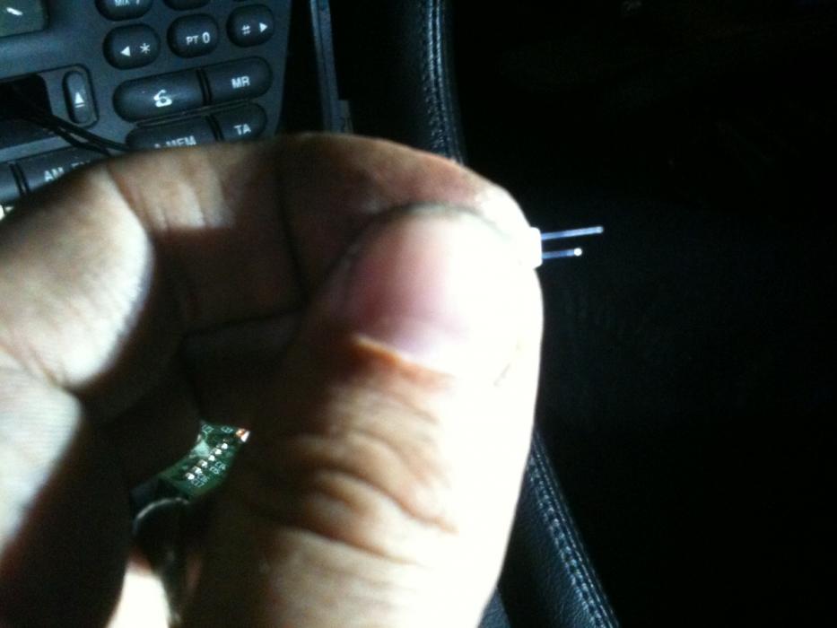

i've done the same job today...i ordered the exact radio shack part number and soldered them in, order a few extras as i broke one trying to do it...total pain in the butt...here are my pics...i cut the pins of the light to different lengths to make it easier to solder it in...it is nice to have the light again...i just need to do the same to my cruise control and sport button back lights as those have been out for a while...
