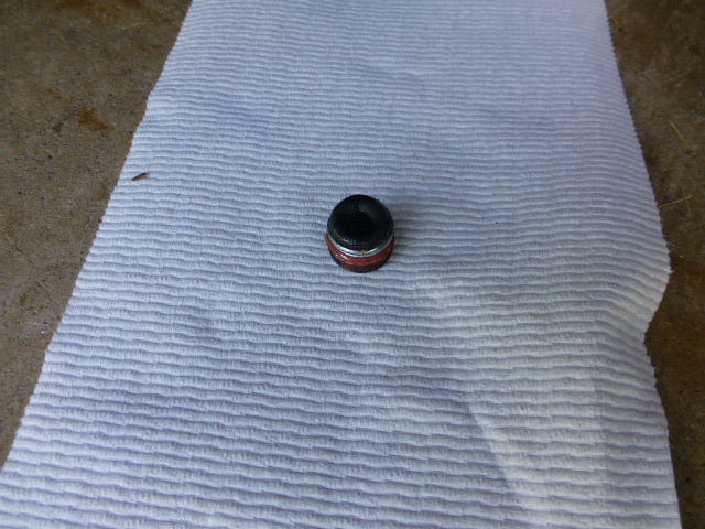

Did mine yesterday. Had to heat bend a length of narrow hard plastic tubing to get down to the bottom of the differential. After that it was just time consuming sucking the old stuff out and pumping in the new stuff. I used BG Ultra-Guard Heavy Duty Full Synthetic Gear Lubricant 75W-140 API-GL-5. The plug did have a thick cap of fine metal particles in sludge.
I could not get all of the 1.32 quarts out but probably about 1.1 - 1.2 . I spilled some which is why I did not get an accurate reading.
This is at 103,000 miles.
