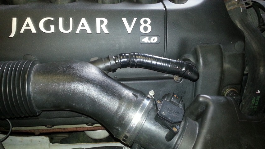

Remove the old breather hose by pressing down on the clips and pulling upwards or outwards. Seen here all taped up by the previous owner
After removing the tape I was left with pieces. Slit the pieces that are on the barbed fittings on the ends and use a pliers to assist in removal.

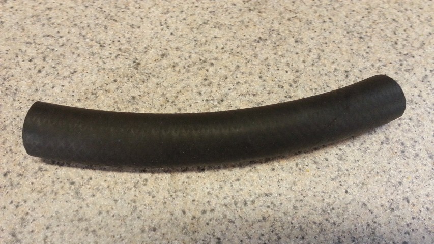

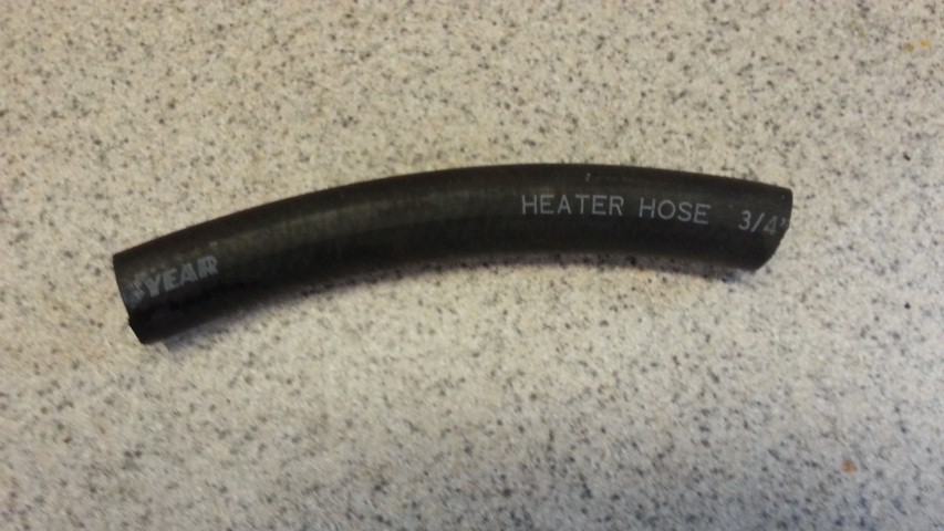

Below is the hose I used
I used a bit of acetone to remove the lettering

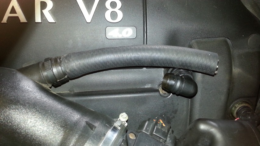

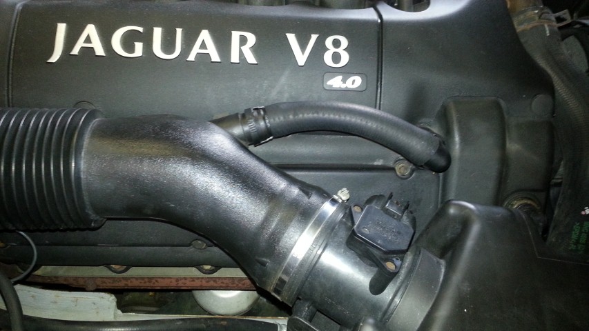

Put on end on the hose and seat properly on intake tube, insert the valve cover fitting and mark for exact length. Leave a slight curve to allow for engine movement.
Press hose on remaining end. The barbed fittings and tight hose allow for a perfect seal, no need for clamps.
Stand back and admire your work.
Takes less than 10 mins and for me, I had the hose on hand so it was free too.

Just so you know, heater hose isn't oil and fuel vapor resistant, both present in that crankcase vent line. It'll work until the rubber turns to goo from the inside out and collapses.
Old Mar 18, 2013 | 04:30 PM
Probesport's Avatar
Joined: Feb 2013
Posts: 458
Likes: 131
From: Metro Detroit, MI
Well aware and that takes a looonnnnnnnggggg time. I've done it on quite a few times. Fluorosilicone would be the best bet but I don;t have any in 3/4" and fuel line doesn't easily come in 3/4" either.
This will get through many years before it starts to degrade with the small amounts of oil it comes in contact with.
I just dug up some of the info on the new Goodyear hose (which I used) and they are worlds better than the dimestore junk from days past.
"Goodyear heater hoses are designed for vehicles that need custom-routed heater hoses. They meet or exceed SAE J20R3, D1 specifications, so they'll stand up to the heat. Goodyear heater hoses use rugged construction; they're manufactured from Versigard rubber, a compound highly resistant to heat, oil, and weather. Their patented knit reinforcement is made with Tylanar fabric, a material that also meets SAE J20R3, D1 requirements. So, when you want your hoses to outperform the competition, choose these Goodyear heater hoses to get the job done."
