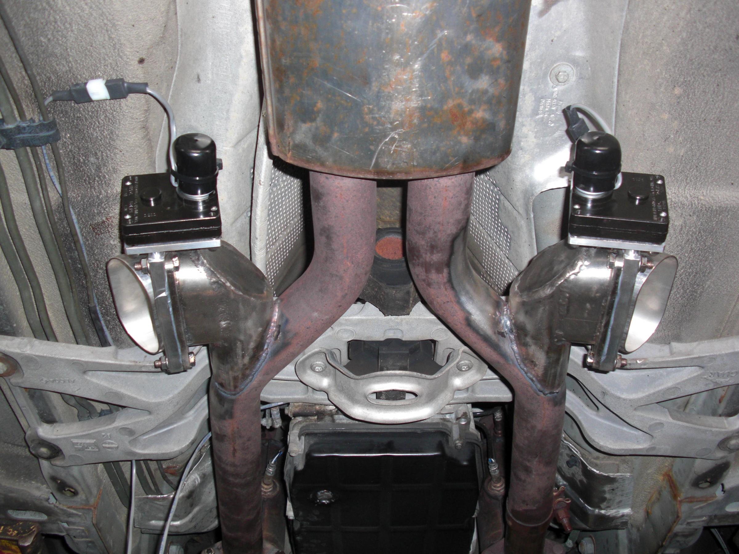

Originally Posted by Muti007
Also, are the inlet and outlets centered or on one side or another?
See install pic below, you can see where they are. Right behind the cats and centered, blowing out each side.
Delete the center muffler and replace with an X pipe. Remove the rear "resonators" and replace with straight pipes.
Backpressure? Jeeze! We have beat this horse to death already.
This exhaust mod is about sound and fun, not performance! If it doesn't make you smile and laugh out loud when you open the cut outs and put your foot in it then you should be driving a Prius anyway, lol.
I ran my XJR at Road Atlanta in November with the cut outs open all the way and did not notice any decrease in performance.
The factory system provides great performance, maybe a bit restricted over the rear axle, but if you want more HP go with a smaller supercharger pulley.
