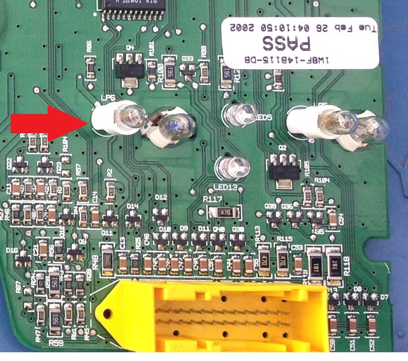

When you turn on the ignition and the instrument lights perform a test, does the Airbag Warning Light come on? If not, then the system will emit a series of beeps to indicate a fault with the airbag.
If so and you need to change the bulb, look at my XJ8 renovation thread and you can see how to get to the bulb for the airbag warning as it's not accessible just by removing the instrument pack.

Here is a link to my post, I've also added a photo here to show you which will be the air bag bulb.
https://www.jaguarforums.com/forum/x...vation-166459/

Okay, so I remove the cluster and access that circuit board from the rear? Or can it be accessed in another way.

You will have to remove the instrument cluster from the car, it's not a hard job.
Opening up the rear of the cluster requires a torx screw driver to undo the screws, and you will need to GENTLY lever the little plugs off the top of the circuit board. These go to the needles themselves. Underneath you also need to GENTLY lever the red plug off it's receiver which is you message centre plug. Then you should be able to remove the board from the housing.

The bulb arrowed is not the SRS ...the SRS is a led not a filament lamp
