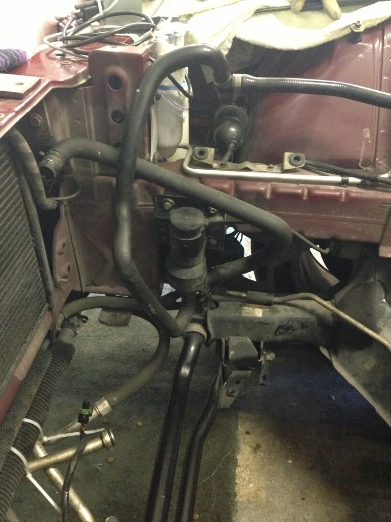

Yes it is electric, and here it is.

Thanks. I'm sure that is where the noise is coming from. Is it much of a job to replace it?
