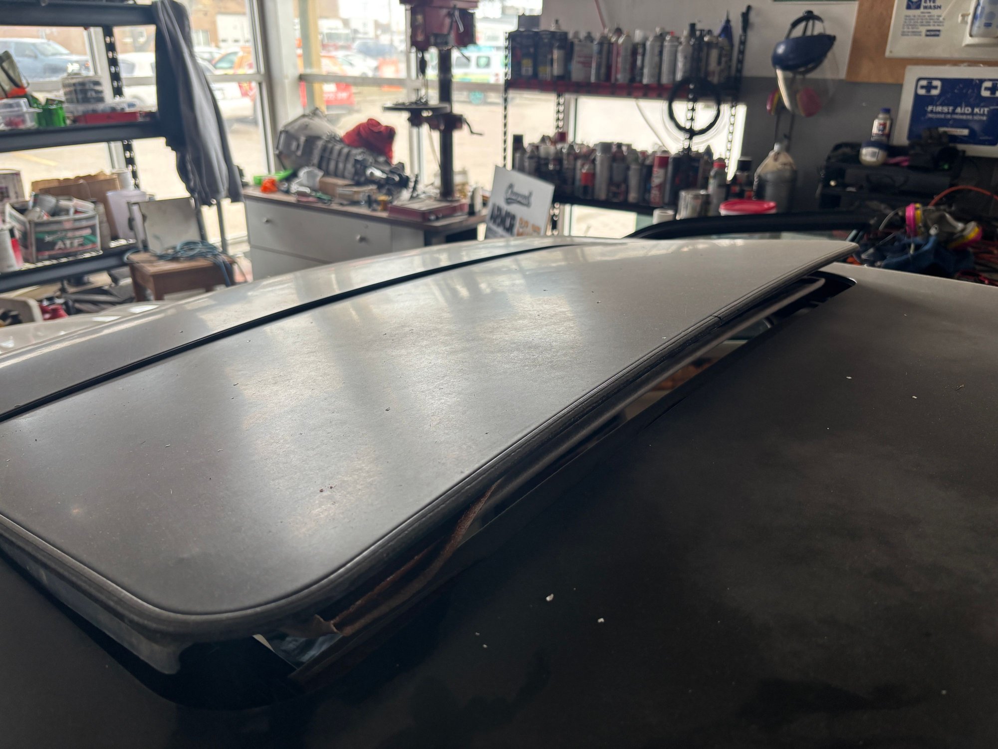

Going to attempt to replace the fabric. Still tryna to understand the method explained anyone have any luck.
