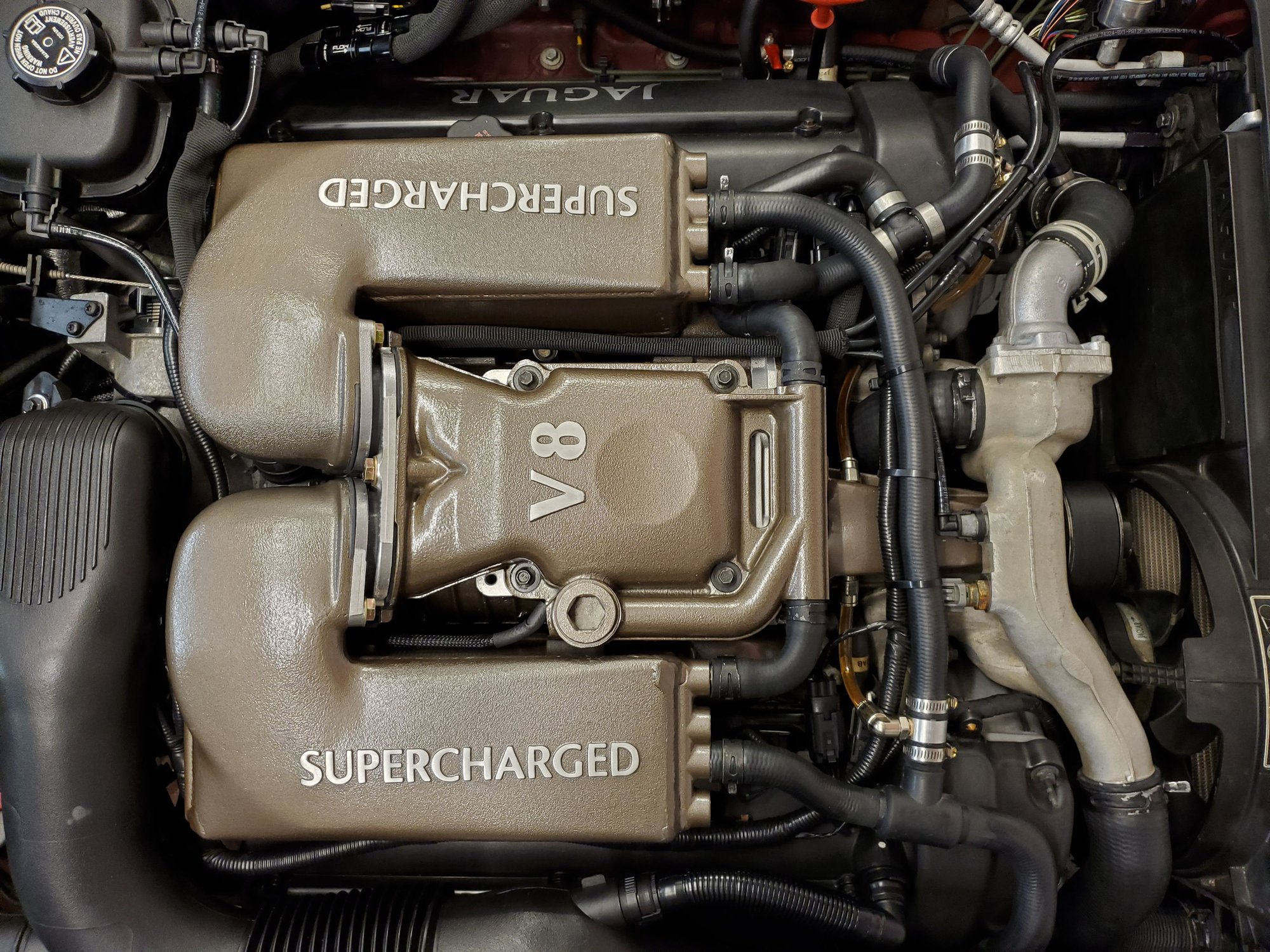

Here is one pic that I have on hand of the final product. I've added some extra abrasion protection to a few of the rigid coolant hoses. I also added a catch can between the part load and throttle body elbow vacuum port.
I've since taken it back apart to do some extra cleaning and I want to cover a few more hoses with the fabric heat shrink you can see here. It should end up being pretty neat.

I really like that. Nicely done!

Looking great! What are those lines on the top left in front of the coolant tank, fuel cooler?

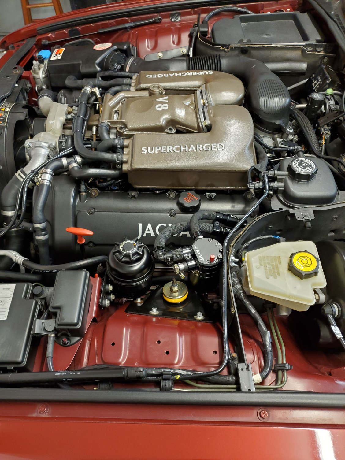

That would be the catch can. See here -
I still have some work on the catch can lines to clean them up a bit but it is in working order as you see it here.

Most of my catch can install was based on 60Gunner's post seen here. - https://www.jaguarforums.com/forum/x...er-mod-251077/
I bought the ADD W1 baffled can V3.3 and connected the inlet to the part load breather in the valve cover. One of the outlet ports is routed back to the intake elbow where the part load breather was originally connected to. I added check valves also sold by ADD W1. I'm a big fan of preventative maintenance so I covered just about everything with a fabric heat shrink material I found at cabletiesandmore. I haven't added the secondary vacuum pump yet but I do plan on it soon.
Stiegemeier rebuilt by SC and had the rotors recoated. They also did the paint job on the SC and air chargers. The front drive cooler is one of their products too.
All belts, gaskets, pipes, and hoses were replaced during this process; from the octopus to the coolant reservoir overflow, throttle body coolant hoses to coolant temp sender o-ring. I put together a list of most if not all the stuff I replaced here. -https://www.jaguarforums.com/forum/xj-xj8-xjr-x308-27/cooling-hoses-under-supercharger-152089/

Phoenix, did stiegemeier integrate some sort of mini heat exchanger on top of the snout drive to keep it cool??
