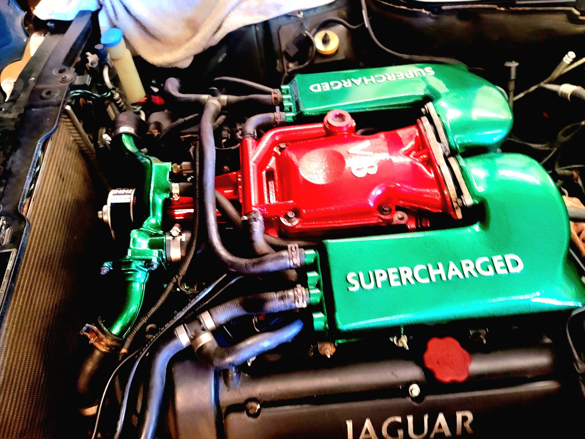

There is a thread within the last year of a forum member going all gung ho having his AJ26 TB bored as he has access to some machine shop. I hope he made it happen. I don’t believe he has followed up on his progress on here though. Perhaps a thread search, post an update on his progress (if any) or a PM would get him to post any updates in return. I don’t remember his screen name.

That gung ho guy is me. I completed the throttle body including the throttle plate but have not yet gotten the car back together. My original plan was to wait and make sure there were no issues before updating the thread etc. I will do so now though.
The throttle plate is not easy to make. It’s difficult to get a very precise measurement on what the angle is when it’s closed, so as a result it’s difficult to do the math on how much larger it needs to be to properly correspond to whatever your bore winds up being. In addition, the shaft needs to be modified as the slot the plate sits in needs to be made wider.
The stock plate leaves approximately .001” gap all the way around when closed. Mine is at around .002” This may result in an issue, but only testing will show for sure.

Sorry . I have been busy lately with my personal matters. I don't have much time to repeat. But I rebuilt my TB and SC the past 2 years with all possible upgradeupgrades.
You can search my threads. My TB is ported not bored. NoT by maxbore . So butterfly flap is original then rebuilt.
​​​SC i rebuilt basically with all the option boxes checked.
I can share all of the vendors information

Porting the throttle body without increasing the diameter of the throttle plate isn’t going to yield anything at all. You can do it, but could also just save a few bucks. Porting the SC is basically the same. A gen 5 unit is cheap on eBay and those are optimized from the factory. Just save your money.

I don't want to grill you on the forum as a newer member but theory and reality are 2 different things.
I have been with this forum longer than I could even remember. you are not all wrong porting is not as good and ideal as the full bored. but saying porting both TB and SC are not going to do anything and save a few bucks is a wild statement that I could not hold myself anymore to respond.
I did it ,tested it and experienced the power gain and exactly the difference it makes so I have the solid right to say what I can say from my primary source and first hand experience.
