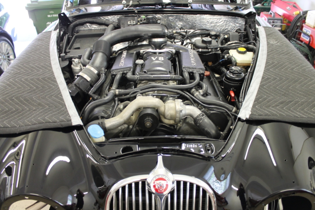

Plumbed up a temporary air intake to fire the beast up - after sitting on the floor for 3 years the engine fired right up and settled down to a steady 650 rpm idle. I have a Restricted Performance message - the only code showing is P0332 Knock Sensor 2 Circuit - Low Input (Bank 2). Checked the manual and there are only 2 steps - unfortunately step 1 is remove supercharger. Before going there I thought I'd check if this is a common failure and cause for Restricted Performance. The donor was a totaled 2001 X308 with 70k miles - running/barely driveable and showing no codes at the time. Appreciate any thoughts.

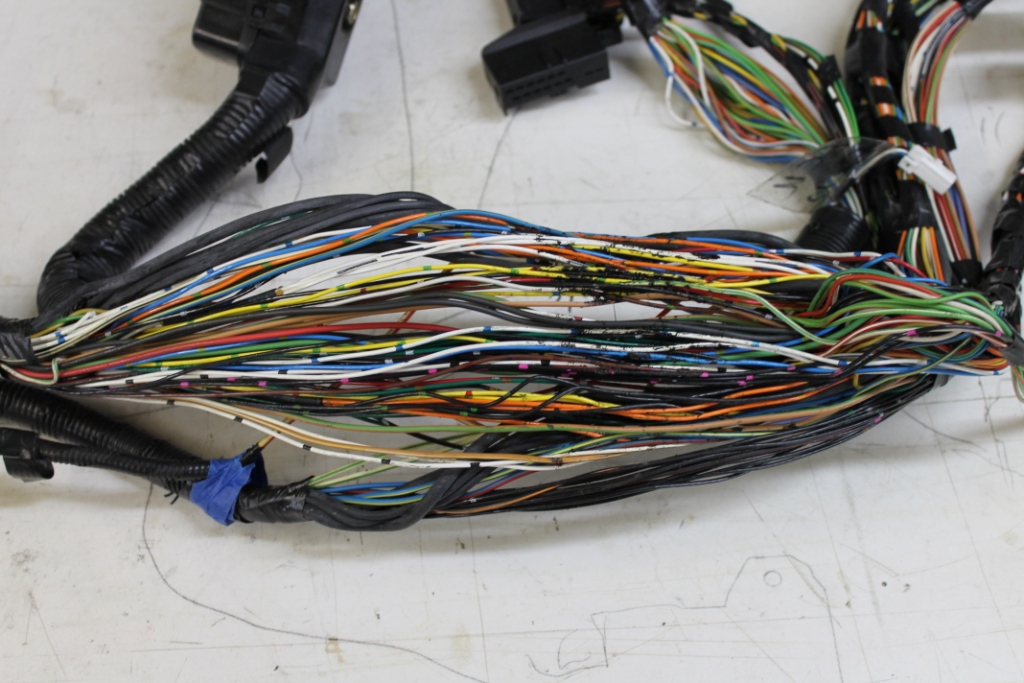

Thanks for the coil advice. I noticed the coil harness plugs are adjacent to the knock sensor plugs that I've been fooling with and sure enough - a simple disconnect/reconnect of the coil plugs returned the engine to its former smoothness. Still have the restricted performance and knock sensor codes. I'm wondering if the RP could possibly be related to the control modules in the doors - these aren't installed yet and I'm wondering if that could be the cause?

Alexander, I had already plugged in a new knock sensor so knew that wasn't the problem. Thanks for mentioning the pinpoint tests in the manual - I had never run across them before. I had already done a resistance check but sure enough there was a short to ground - I jumped a wire to the ECU and the code cleared along with the restricted performance message. I also had a camshaft position sensor fault and knew these sensors rarely fail and knew there was no problem with the cam drives or timing. Sure enough - another short to ground was indicated and the code cleared once I jumped the wire to the ECU. I completely forgot that I had extended the engine harness about two feet way back in the project. Despite the painstaking work (130 wires as I recall) a soldered strand of wire had penetrated the shrink wrap on those two leads and was shorting. Thanks again everyone for your assistance.
