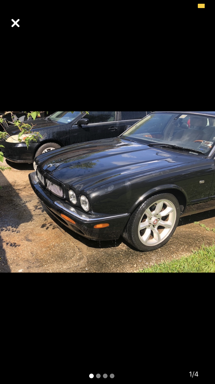

Old Sep 18, 2019 | 07:44 AM
2jags1993's Avatar
Joined: Aug 2019
Posts: 57
Likes: 15
From: Texas
Old Sep 18, 2019 | 07:47 AM
2jags1993's Avatar
Joined: Aug 2019
Posts: 57
Likes: 15
From: Texas

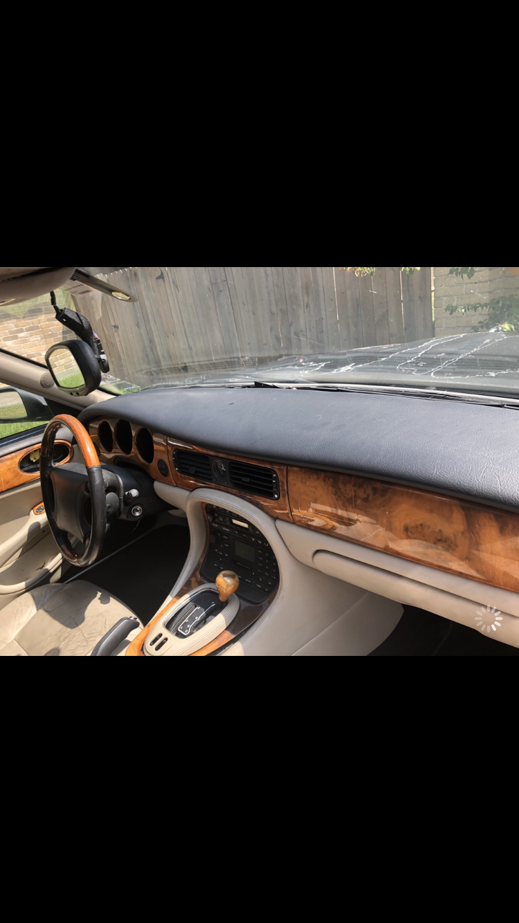

Default Interior
Separation of the wood isn’t good but expected after 10 years in the Texas sun or a humid garage

From: Rochester, NY
Boy that Texas sun! The hood clear coat and cracked dash look very familiar as my 99 came up from the Houston area. Good news is it probably looks pretty nice underneath, except for the deteriorated rubber parts, ask me how I know about that! Good luck with the Merc...
