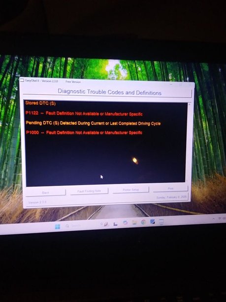

I’ve owned my 1999.5 XJ8 for over 20 years. Over that time, I’ve had Failsafe come up many times. I’ve narrowed it down to the TB several times, and have replaced the TB with a used part, twice.
My conclusion has been, the PPS (left side) fails and is not serviceable. The TPS (right side) is replaceable, but rarely fails. The only solution is to replace the entire TB. (I apologize for the acronyms, but I’m assuming anyone intimately familiar with the X308 TB problems will know what I’m talking about.)
Here’s the current code (1122) I’m getting, intermittently:
c

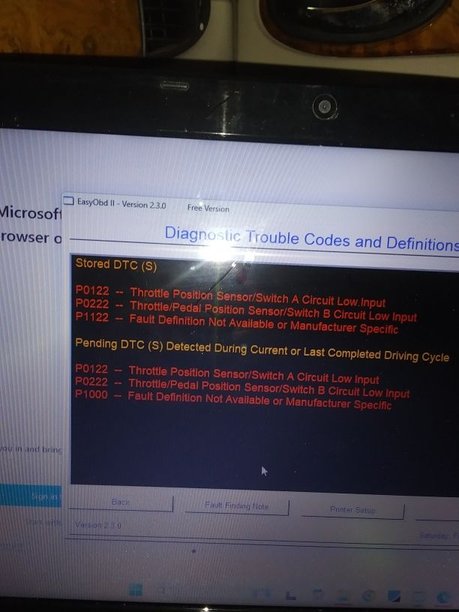

I bought a used TB (2000 XJ8, 88K miles) and got these codes (0122, 0222 & 1122):
Here’s where it gets weird. I assumed the replacement 2000 TB was bad due to age, so I reinstalled the old intermittently failing TB to verify. No code 0122 or 0222, but, after many hard resets, car was stuck in failsafe and kept throwing 1122, as shown in the first pic.

Next question, should I return the 2000 TB as defective? The 0122 and 0222 codes make me think it is… (To make sure, I’m going to remount it and try the relearn process a few more time before I call the part “bad”, and return it. I tried that many times, but not pressing the pedal Before switching on the ignition and Before the computer triggered Failsafe. Pressing the pedal before Stability Control Failure is activated seems to be the key!)

Also, take a look at the second pic in post #1. It shows p0122 and p0222. That's on the (new to me) TB. Does anyone know if that's indicative of a TPS failure, and that the PPS in this TB may be okay? I don't get those codes on my intermittently working TB.

P0122 and P0222 are TPS codes. I attached the code chart for the AJ27 engine as I'm assuming the '99.5 MY has that engine and you're replacing the TB with one off a '00.

Now, I'm thinking the TB I just bought has a bad TPS (0122 and 0222 codes are new and not present on the current TB). I have a known-good TPS and can replace, but then that raises the issue of adjusting it. Also, not sure if my generic scanner has live data on the PPS or TPS. I have the Mongoose Jag cable and V125 software. Will that have the live data? I haven't tried it because the generic scanner is so quick and easy, and I know what the codes are telling me.

Yea, I think the TPS is bad, too, with low voltage on both tracks. Here's a good thread on changing it out and doing the adjusting.

Back to my situation, I had planned to test the TB that showing the faults in pic #2 in post # 1. That went to hell when my existing TB got stuck in Failsafe when I tried to pull the car in the garage. Long story short, I spend my time trying to get the car in the garage, only to find point 1 to be true: Testing requires removal of the old TB.
