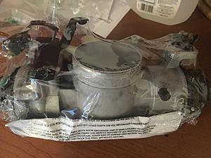

Spare throttle body is at ASI being re-built.
In the meantime I have tried pumping the accelerator slowly through its full range while the ignition is "on" but car not started. Did it ten times then went for a drive, no problems. Did it 10-15 times before each of the next 3 starts. Still no problems or codes.
Certainly not conclusive, but it appears there may be potentiometer corrosion?

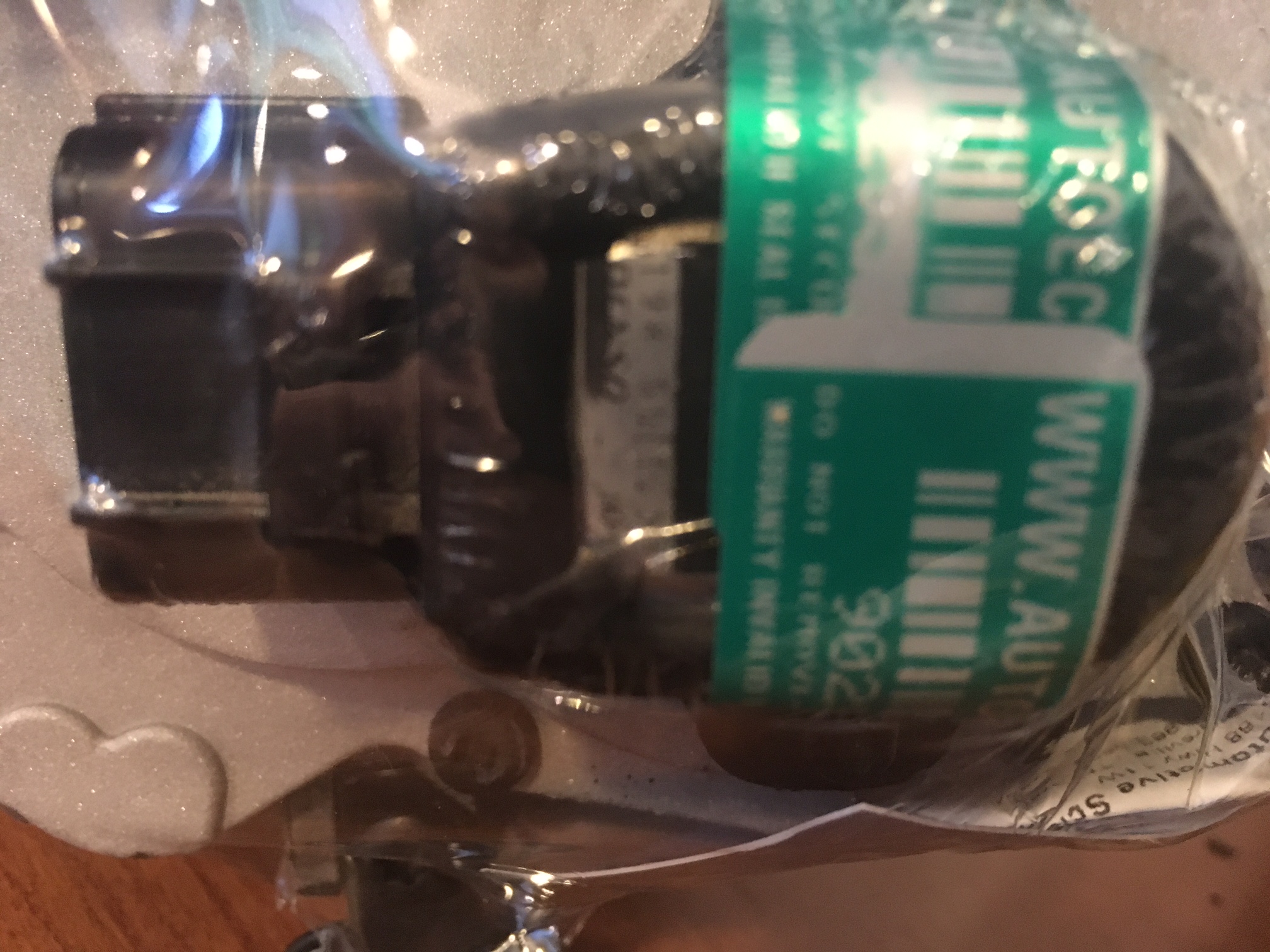

They turned it around in just a few days. It looks cleaned up and nice. The next time my car throws the p1121 code maybe I'll swap it out. The code hasn't come back since I have been cycling the accelerator occasionally just before starting the car.

Since the TPS looked like the same old one that was on the unit when I shipped it off to be re-built I asked them about their procedure regarding that item. This was their response:
"Our remanufactured Throttle Position Sensors and pedal switches are entirely gone through, We dismantle the sensors and replace the internal parts that tend wear over time."
It looks like grandell was right.
