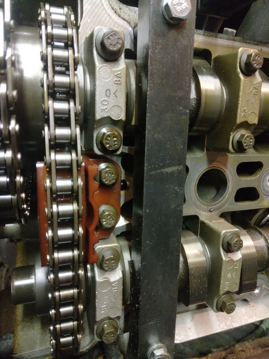

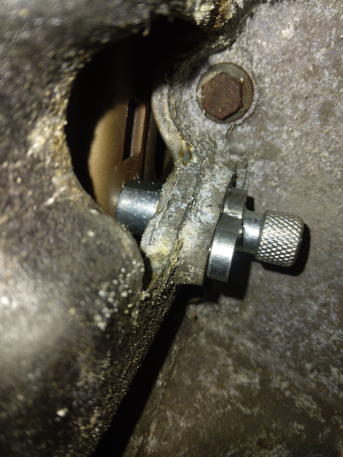

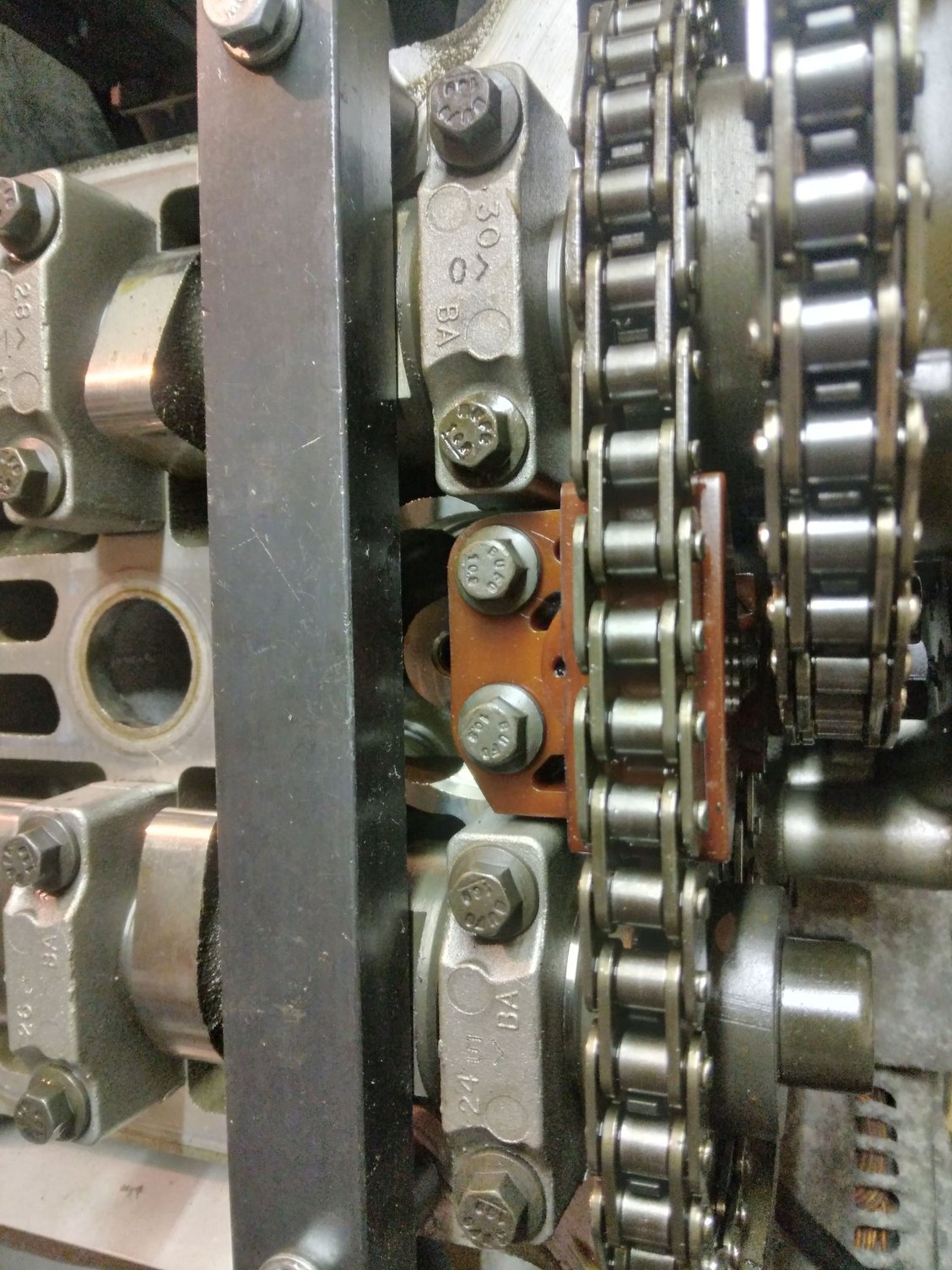

Well Gentlemen, I finally got to working on the VP again. After inserting the locking pin into the flex plate, I found that the flats of the cams are inline, indicating, of course, that timing has not changed on either bank. I did notice a little slack in the primary chains that had escaped me initially. The tensioners are most definitely plastic, but before I replace them, I need to know why I have no compression on any cylinder.
Due to my workload, I'd really like to avoid pulling the heads if at all possible, and at this point can only speculate stuck exhaust valves, however, the cam followers are returning to the closed positions as the lobes turn away from them so I don't see how that can happen without the valve closing. Burnt valves crossed my mind, but all 8 cylinders at the same time? Not so likely. What else could cause a complete loss of compression through the exhaust? Unless you guys can come up with a magical solution, it would appear that I am condemned to pulling heads.

Assuming that engine compression was tested at top dead center instead of crankshaft position, here may be the reason why it let air through
At this point you have not much choices left, either threat it as bore was, drop some oil and try to start or inspect it with the boroscope camera, given your timing is intact there is nothing wrong with just starting the car

Remember, valve and timing chain covers are removed and the engine has no throttle body. That was removed and sold before we bought the car. I'll buy another one if I can get compression and all else looks good. So that precludes simply starting the engine. And since the compressed air exited the cylinder only through the exhaust when the cam lobes were off the lifters, this indicates an exhaust valve problem which led me to the bent valve thesis. Now with the timing not a factor, this leaves stuck exhaust valves as the only possibility, but, there's a problem. As the cams rotate, the followers go down and come back up all the way. Presuming the valve springs are pulling the valve stems up, and the end of the stem is pushing the follower, this would seem to indicate normal valve function.
I had considered gasket failure, but all 8 cylinders? Not a chance. So, unless you guys come up with something new, I'll be pulling heads.

=which led me to the bent valve thesis. .
Sounds logical but all of them both banks without a jumped chain?
Other wild guess, nikasil lining got stripped due to severe engine overheat.
Me thinks cheap boroscope will save you time and mind bending over the thing

The bent valve thesis was because I initially thought the timing had jumped because I didn't know about the 30 degree crank angle for cam timing. Again, the leak down test had no air coming from the crankcase, only the exhaust. However, I only checked one cylinder. Since there was no compression on any cylinder, I figured they are all from the same reason. I would expect that if it was a nikasil problem, I would have air going past the pistons to the crankcase. I don't see how oiling the cylinders with help this problem, but it will probably be a good thing to do anyway. I can see that I will be pulling heads on my next work session.
