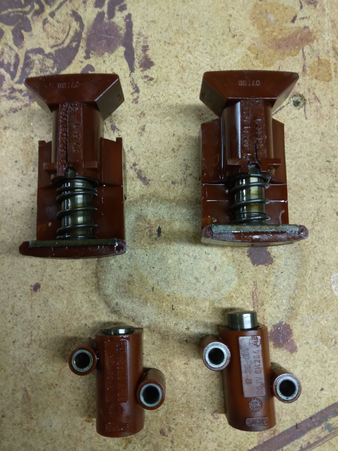

The plastic body primary tensioners have a check ball and use oil pressure to expand the little piston.(the seals can fail)
The metal body tensioners have a 'toothed-ratchet' to keep the piston from retracting.
They can expand but cannot retract without lifting the mechanism by hand.
I was hoping for something like that. Are those the aftermarket kits? are there any manufacturers I should favor or stay away from?

ALL metal body tensioners are the updated kind and they are used with both the Morse style silent running primary chains and roller chains.

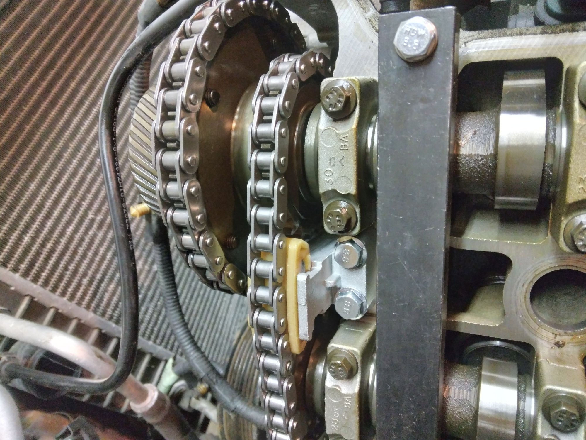

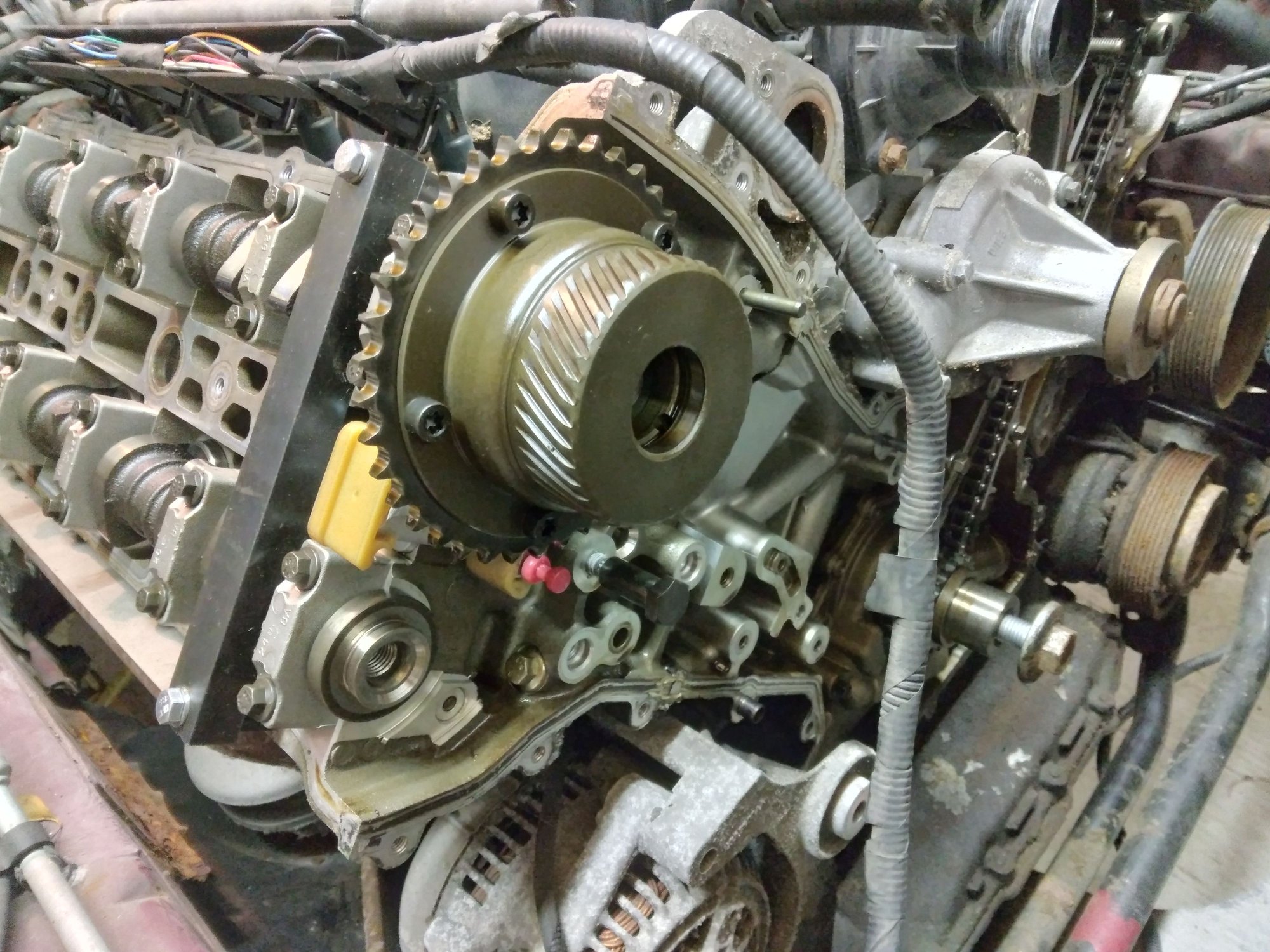

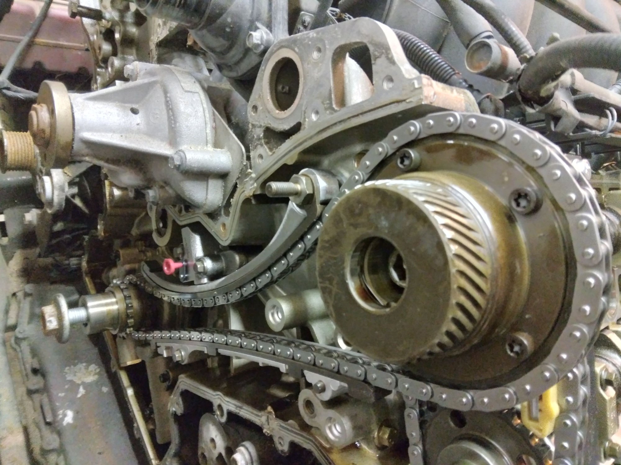

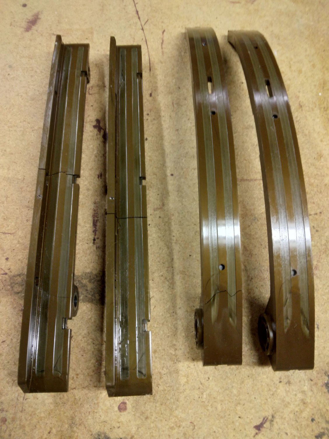

Well, my all metal chain/tensioner kit came yesterday and I installed it today. Close inspection of the original guides shows cracks in the plastic, but no missing pieces. Both secondary tensioners are cracked and the replacements look great. I didn't have torque specs with me so I just snugged all fasteners for now.
I stopped at the bone yard that sold us the car and they had another one with a throttle body that I got for $50. I also grabbed the hood leaper for $25 since the one from the car had escaped. Might I be lucky enough to have a running car at my next work session? We'll see.
