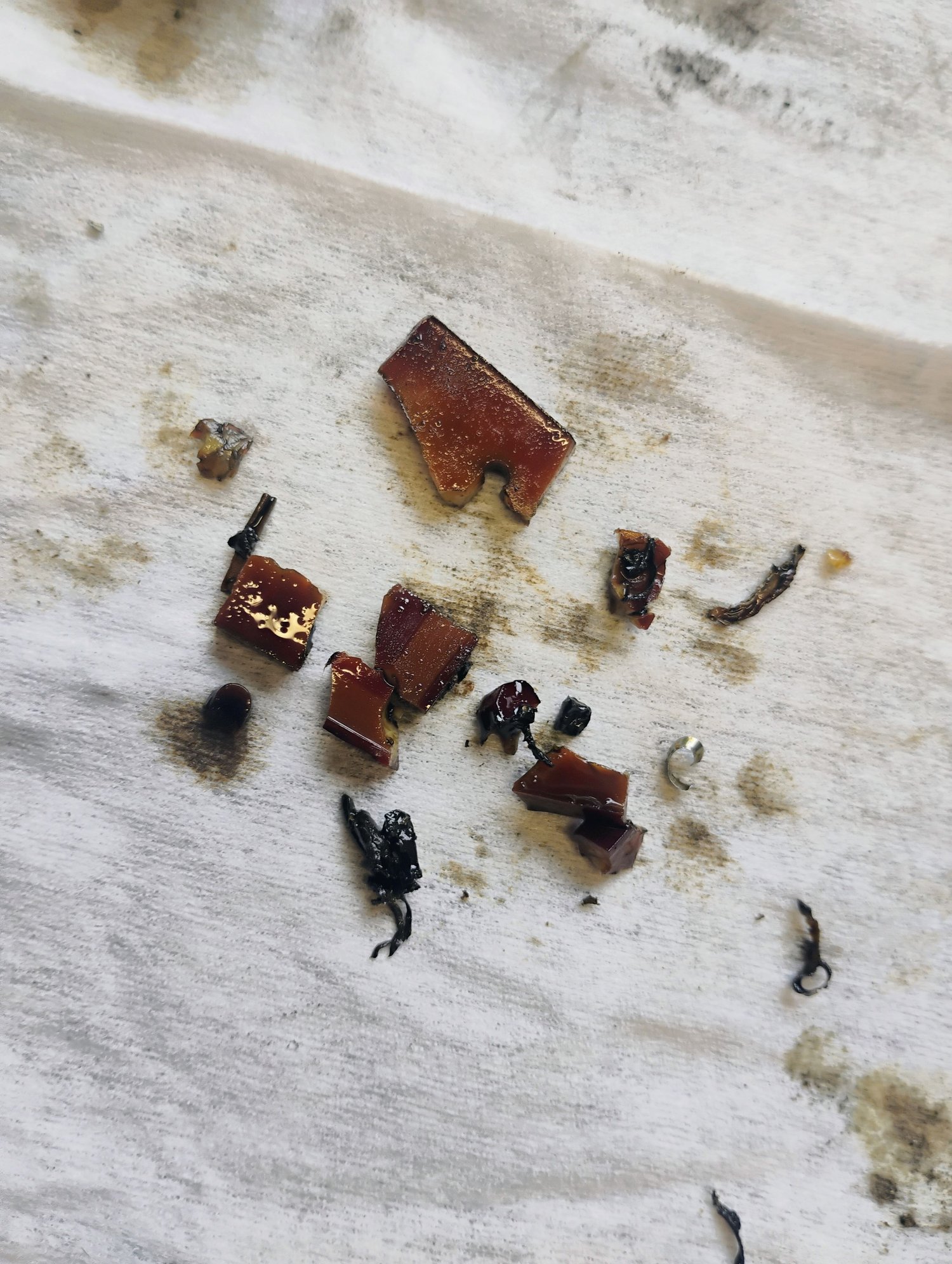

I may have missed if someone mentioned it in this thread, and sorry if I'm mentioning something obvious, but, consider checking your oil pick up. I'm glad I did. I got these tensioner bits restricting mine. A friend completely seized up a motor this way.
jeff x-j8
Thanks for the tip. I will carefully examine the tensioners and guides for missing plastic. If there is, is the oil pickup accessible without major surgery?
