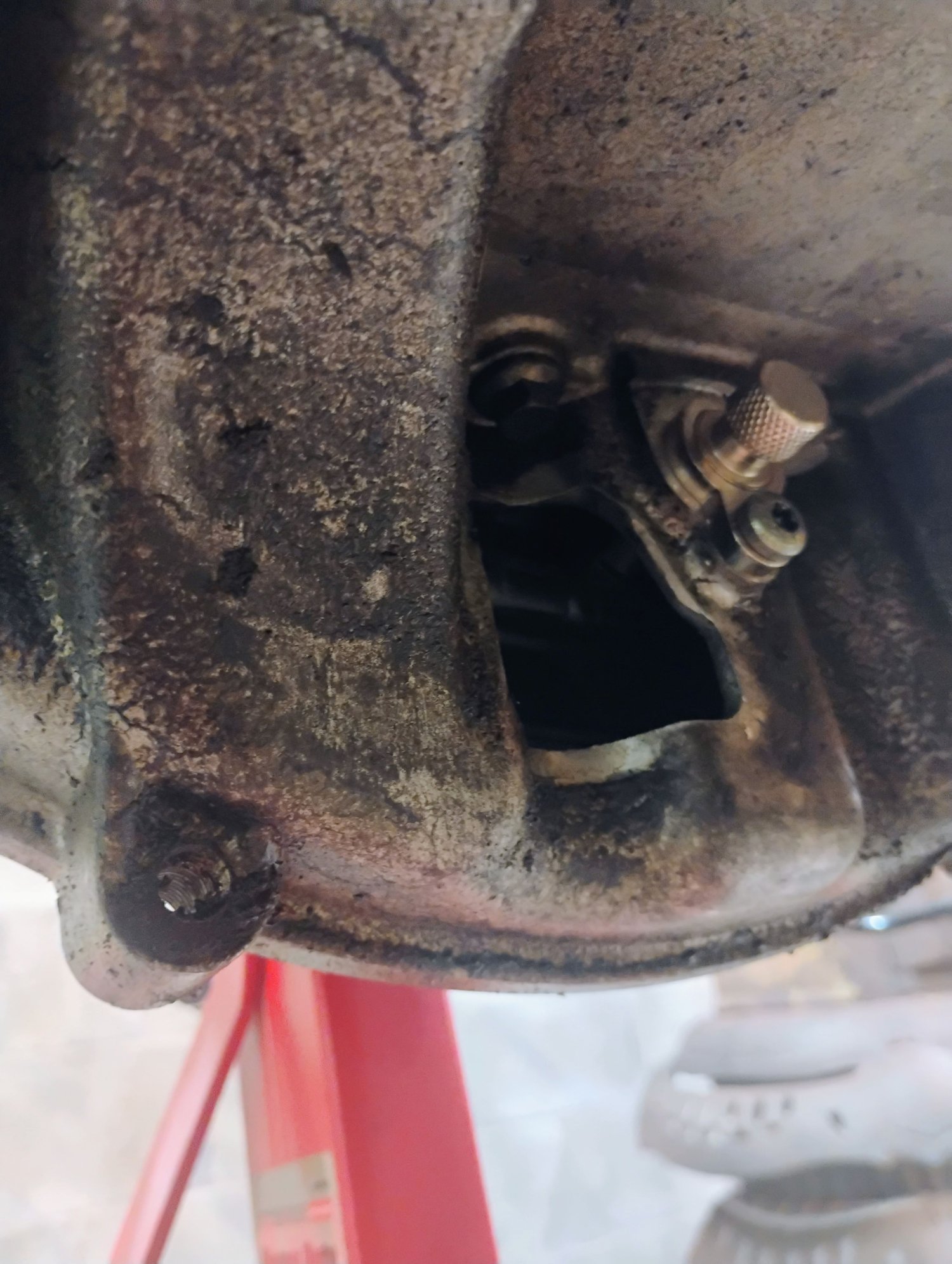

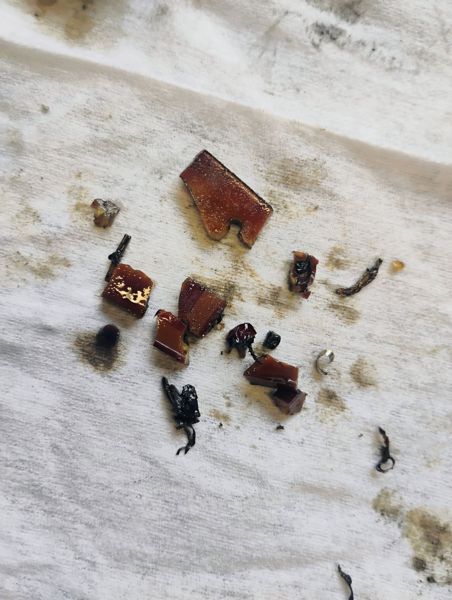

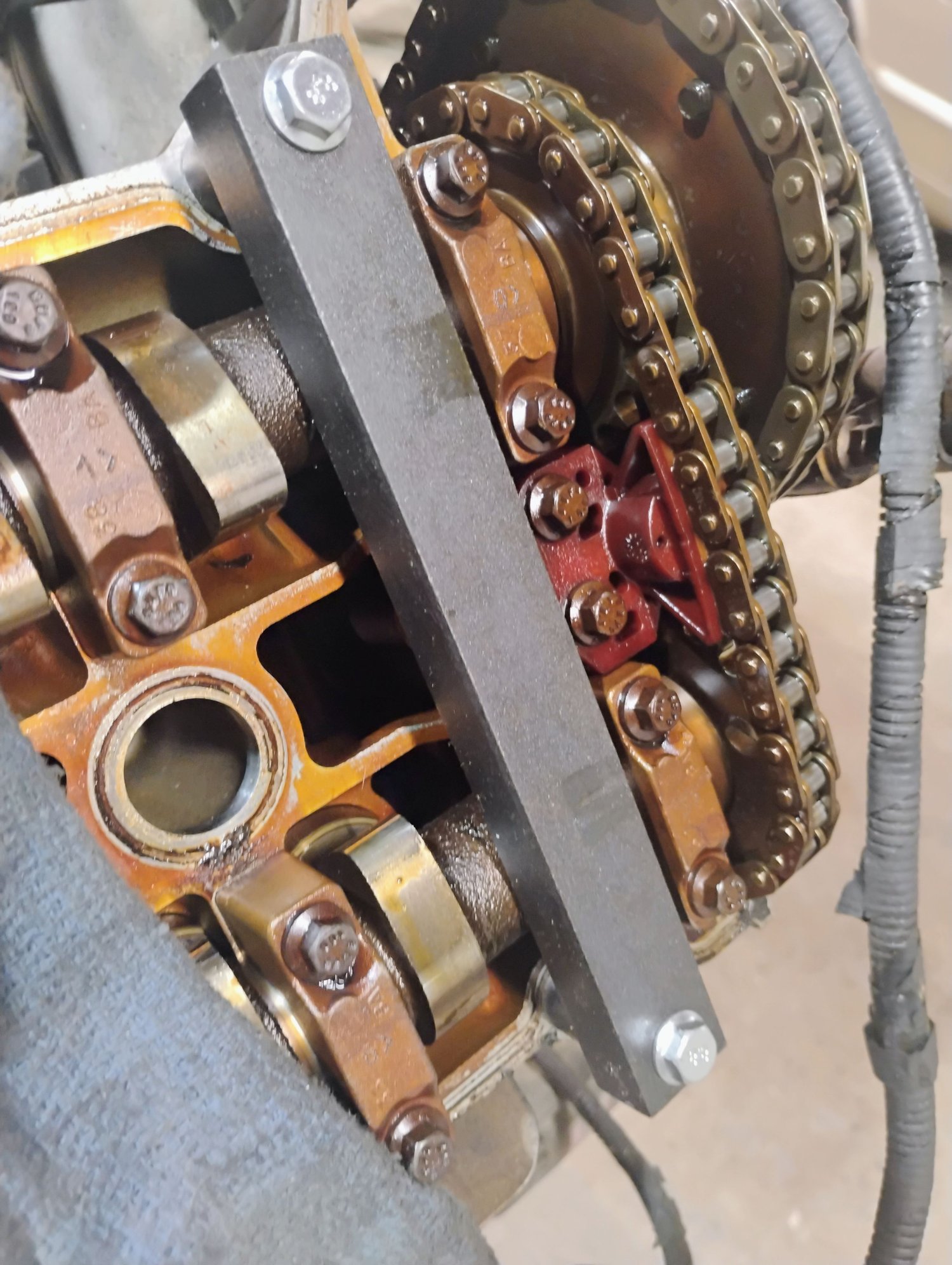

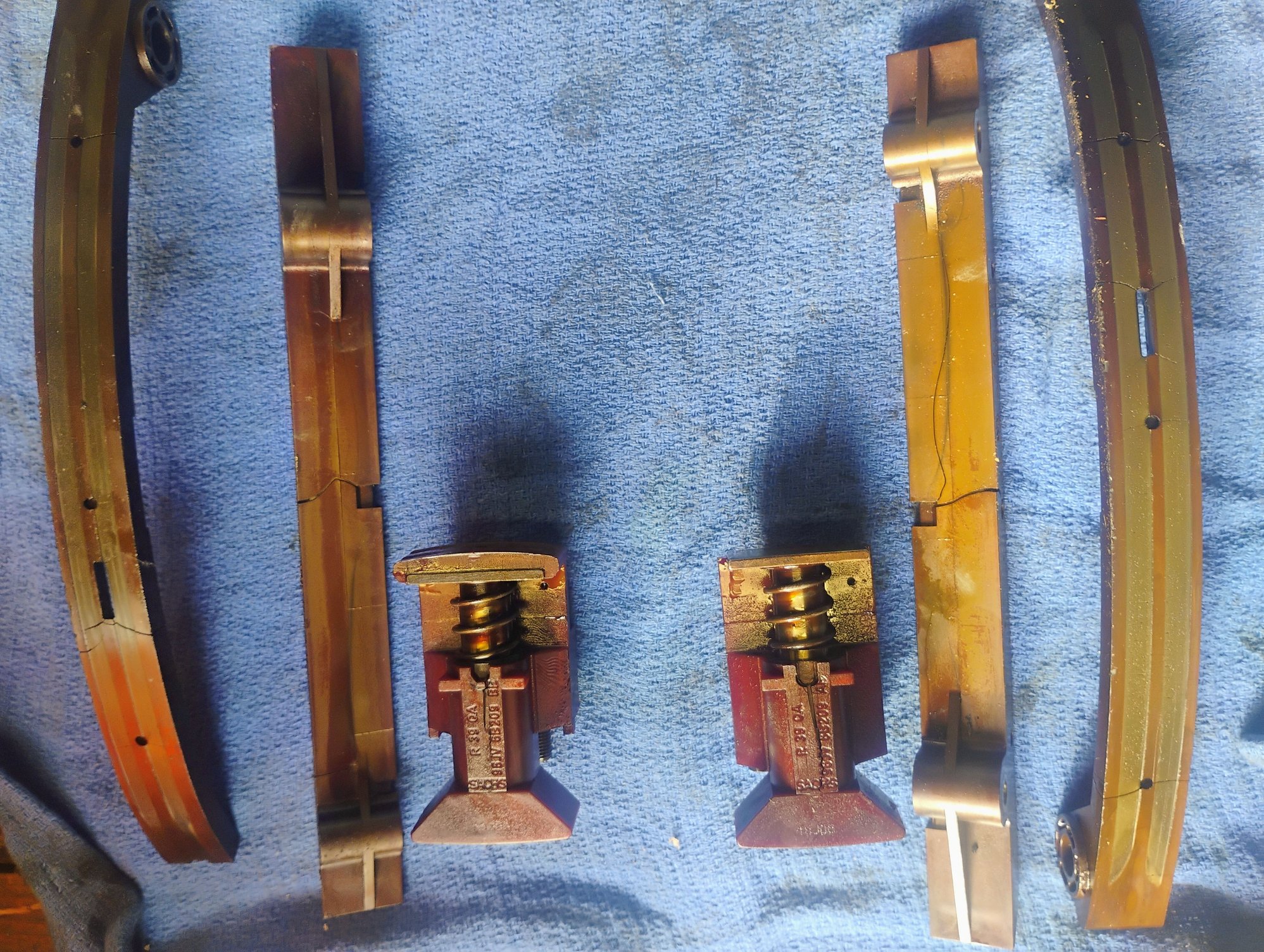

Catbus, are you going to do the work yourself?
I strongly recommend that you get the special tool kit. I got one from e bay for about 60 USD.
With it you can position the crankshaft and camshafts in place and immobilize them while you do the work.
When I did the job the engine was out of the car and much easier to work on so I changed the primary and secondary chains and tensioners which involves a lot more surgery.
Most folks just change the secondaries . If you zoom in you can see where they crack.
jeff xj8
I'm not an expert but with manuals and help from the web and the experts on the forum I was able to successfully do the job.
cam shaft lock
cam shaft lock
worn tensioners
worn tensioners
crank shaft lock
crank shaft lock
tensioner bits from oil pickup

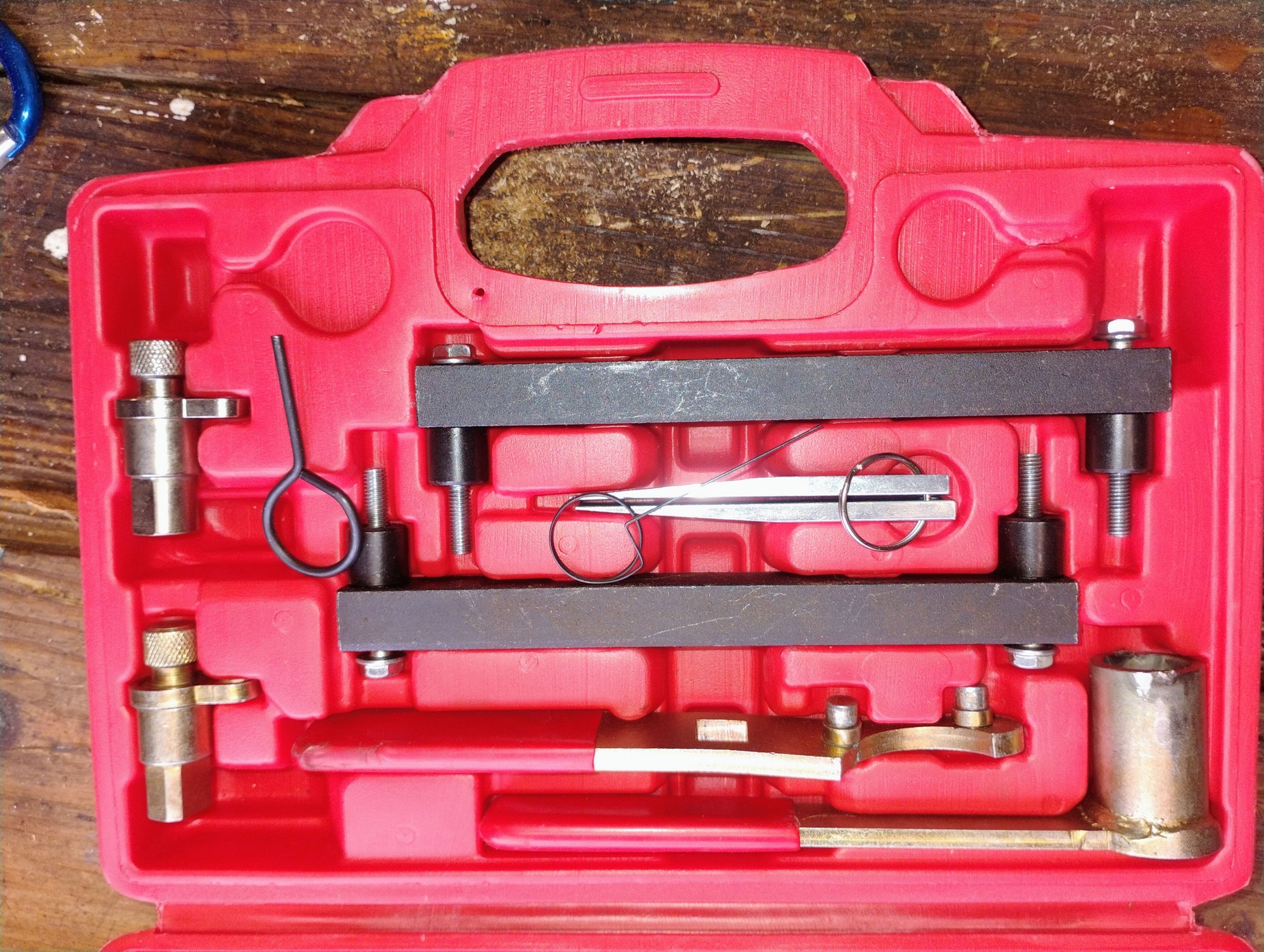

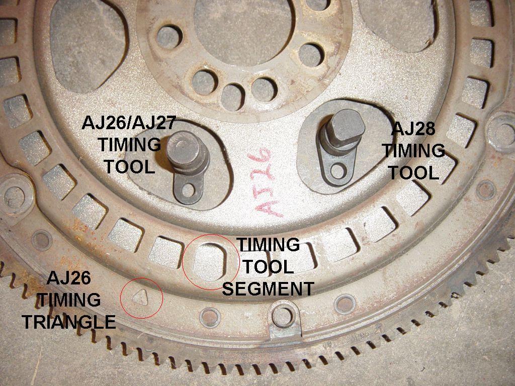

Hi fellas,
Sorry for disappearing. A continuum of non jaguar priorities distracted me.
Cat-as-trophy, the tool kit comes with two different flywheel immobilizer plugs so it can be used on other models but I don't know which.
Cat bus 4451, were you able to complete the job?
tensioner change tool kit
Old May 14, 2026 | 01:44 PM
motorcarman's Avatar
Posts: 13,736
Likes: 9,679
From: Wise County,TX
One crank lock is for the AJ26/27 and the other is for the AJ28.
