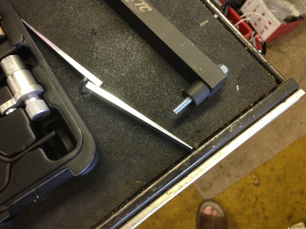

Hi folks,
I've done a lot of online shopping lately and maybe my experience can help others. I just received a tool set from Tools World on Ebay. It was $200 and 15 shipping and it arrived quickly.
I wasn't sure from the pictures just what was in it, so here's some pictures for you.
Attached Thumbnails Timing chain tool review.-null_zpsb79c4a6a.jpg   Timing chain tool review.-null_zps8cefa5c1.jpg   Timing chain tool review.-null_zpsdf36a3df.jpg   Timing chain tool review.-null_zps23458b03.jpg

That's a nice set for $200. Previously that had been almost twice as much.

Yes I found some sets at $400-$500. Really, there's not much to them, and $200 is more than I care to spend, but I don't have the tools to make the pin wrenches. The bars and locating pins could be easily fabricated, though.
I'll probably hang on to them and maybe rent to any fellow Canadians, but I can always sell the set later if I felt like it.
However as a life long wrench twister, I don't ever part with tools as a rule.
I'll post again after I've used them on the engine.

The timing chain tools worked great, I'd recommend them to anyone. The angle reading gauge that snaps on to the breaker bar works very well too. See my post on headgasket repairs for more details.
