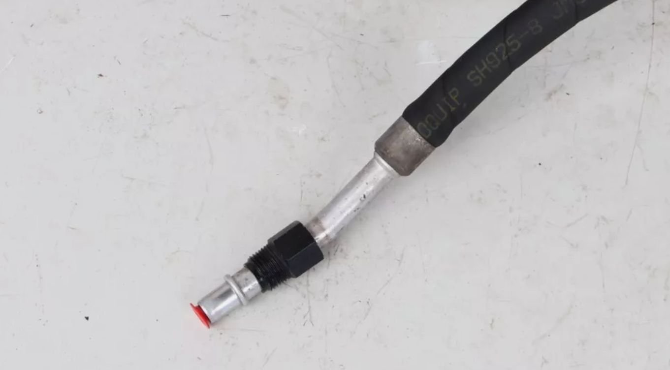

Thanks for the link, although I think these are for replacing the existing coolant lines. I'm looking for the size of the stock connector (sample image attached), ie. a hard line female -> 3/8" barb.

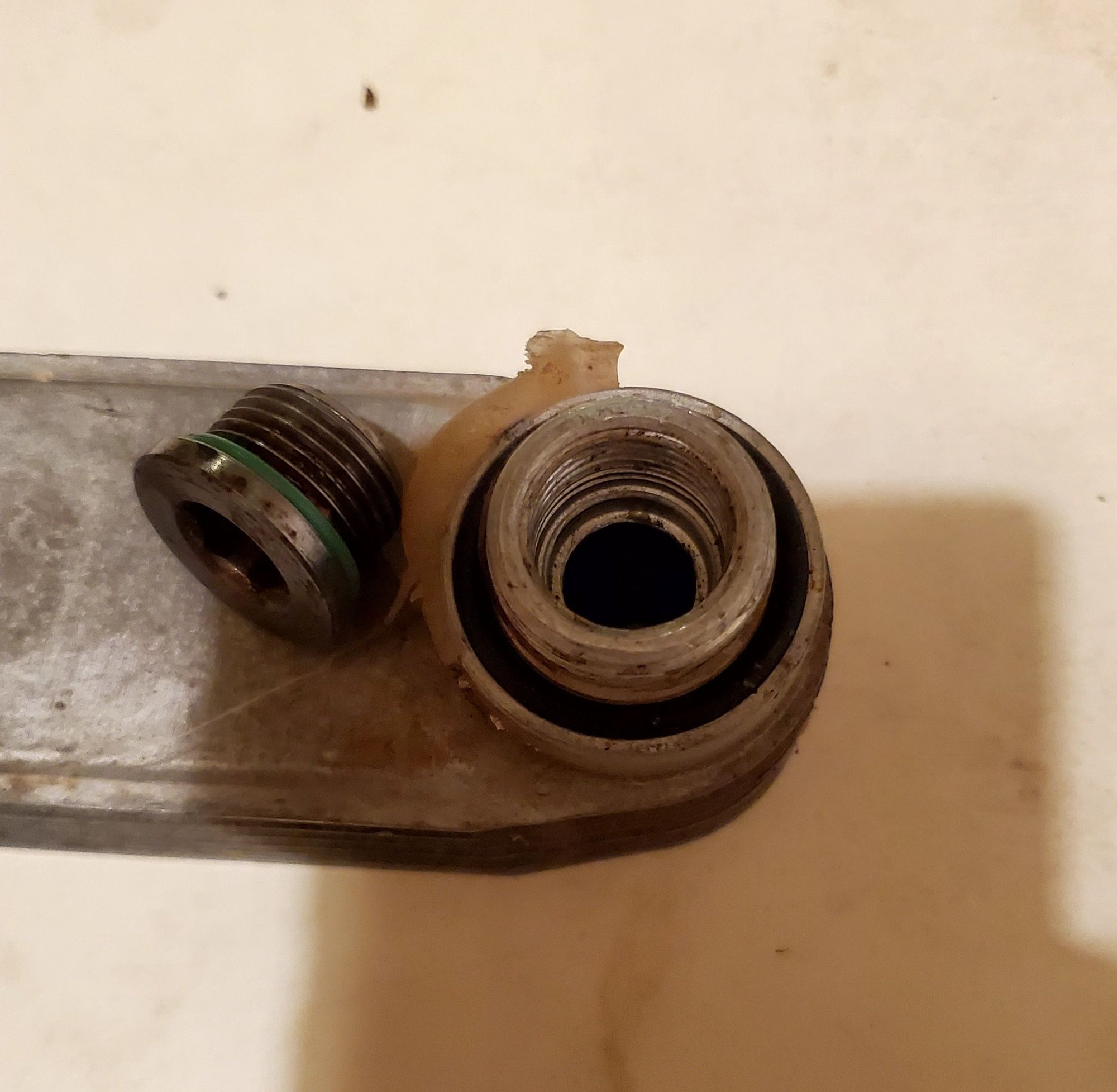

I personally can confirm that m18x1.5 fit the transmission cooler with no problem but it's little bit taller than the cooler thread that's why I used PTFE on the car I'm not metric expert I don't know if AN8 fitting will fit unless he can confirm .
Here's a picture for the cooler disassembled from the radiator and this m18x1.5 oxygen sensor plug it fit fine but it's little bit taller than the cooler thread the one I have with barb on the car with PTFE tape doesn't leak also .
I hope this helps
