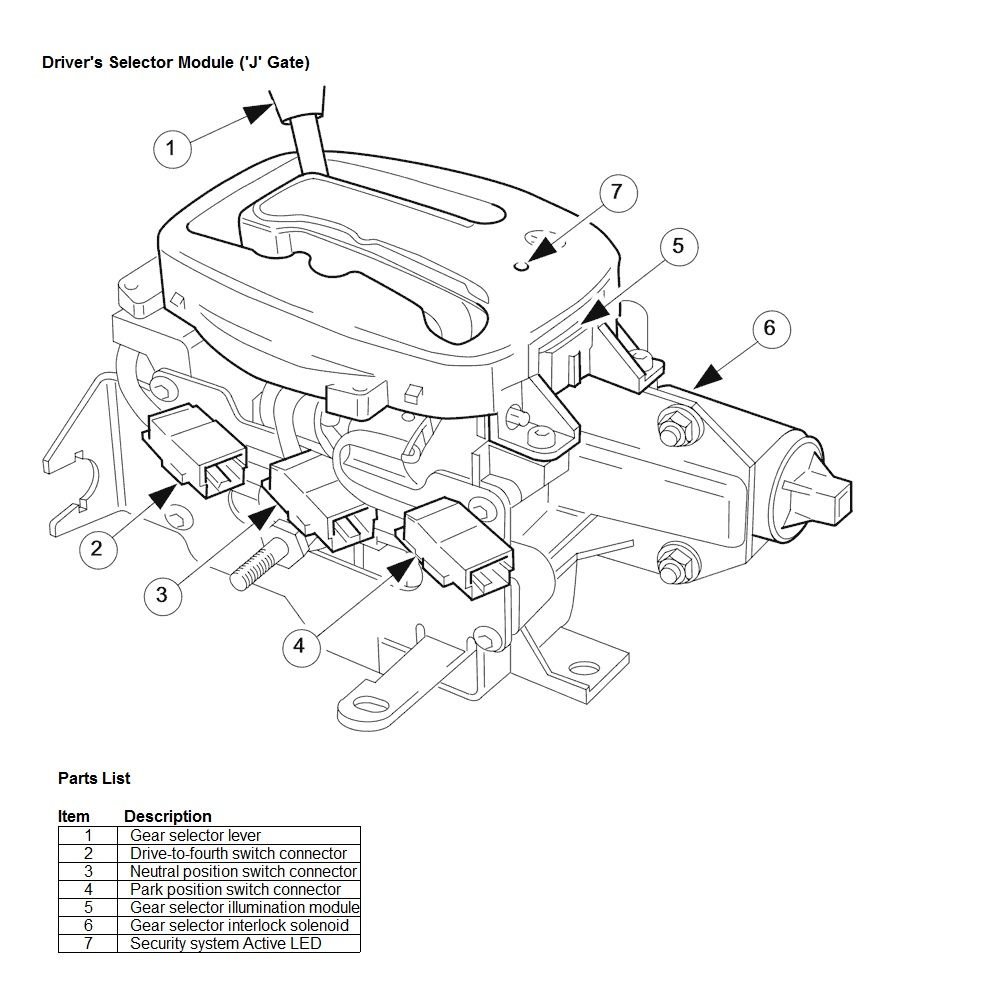

You'll want to check the shift linkage for worn/stretched cabling and check the electrical connection on the shift indicator to include the indicator itself. The detail I posted are from the XK8, but I do believe they are the same.

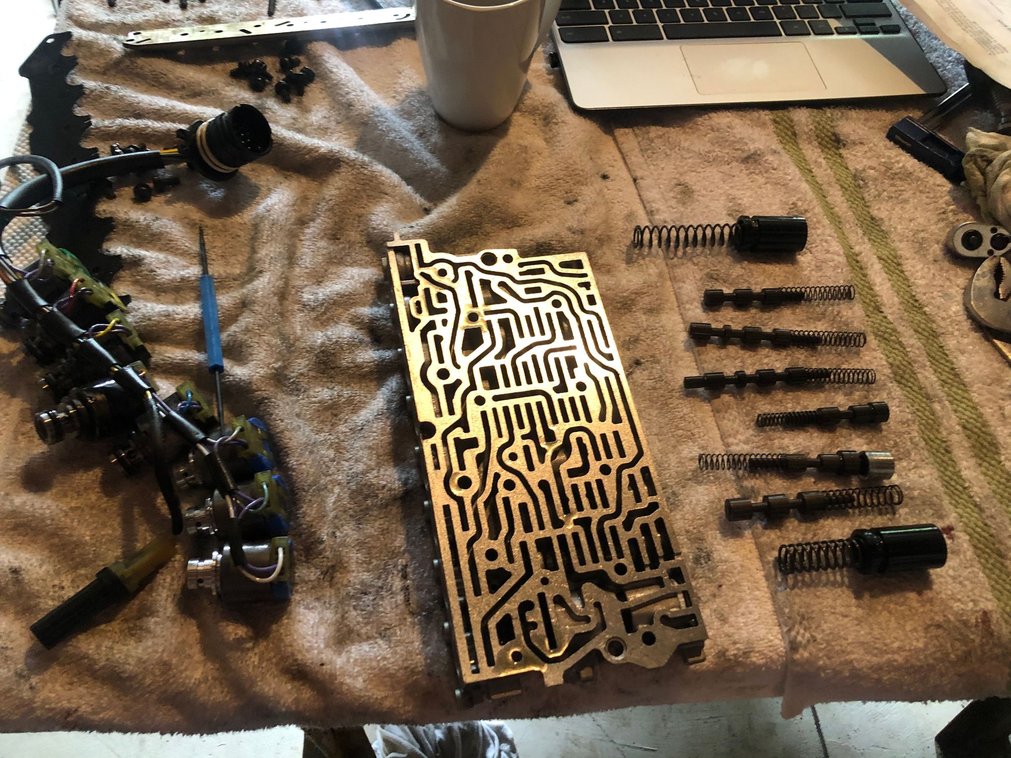

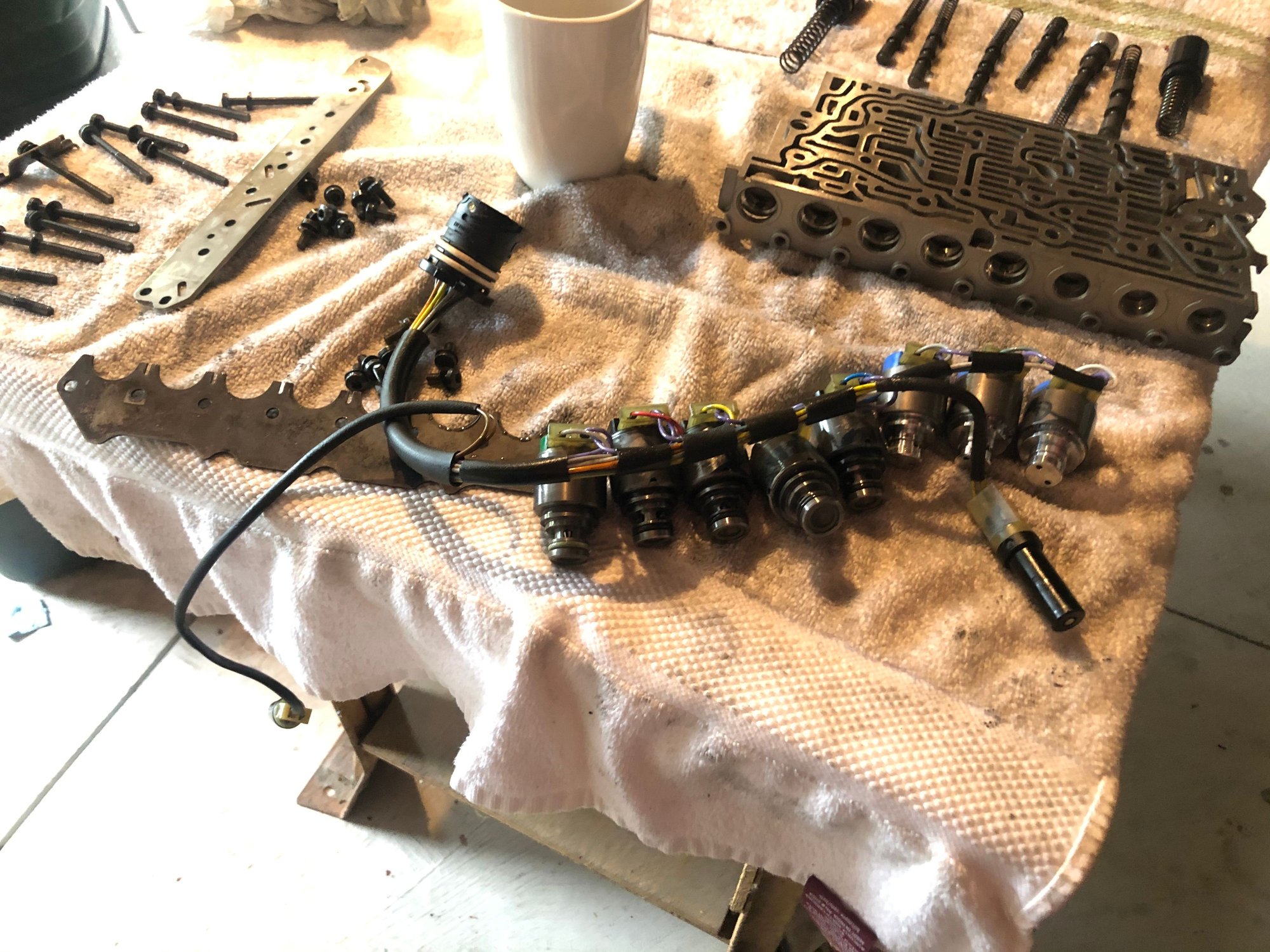

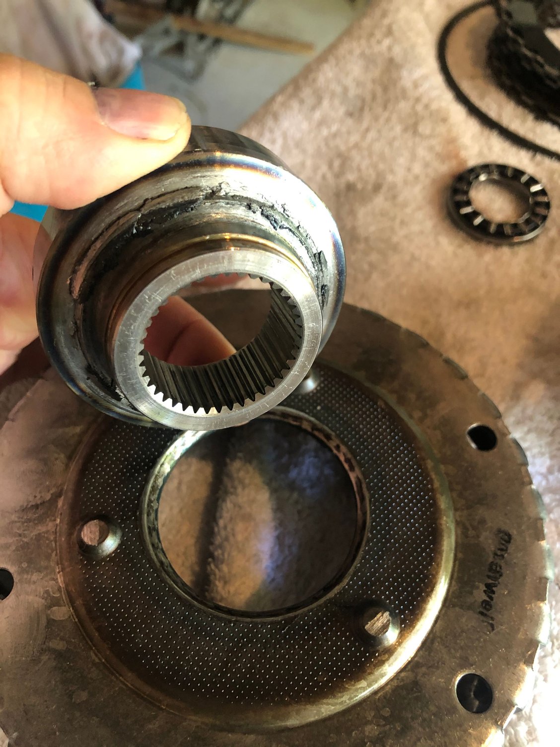

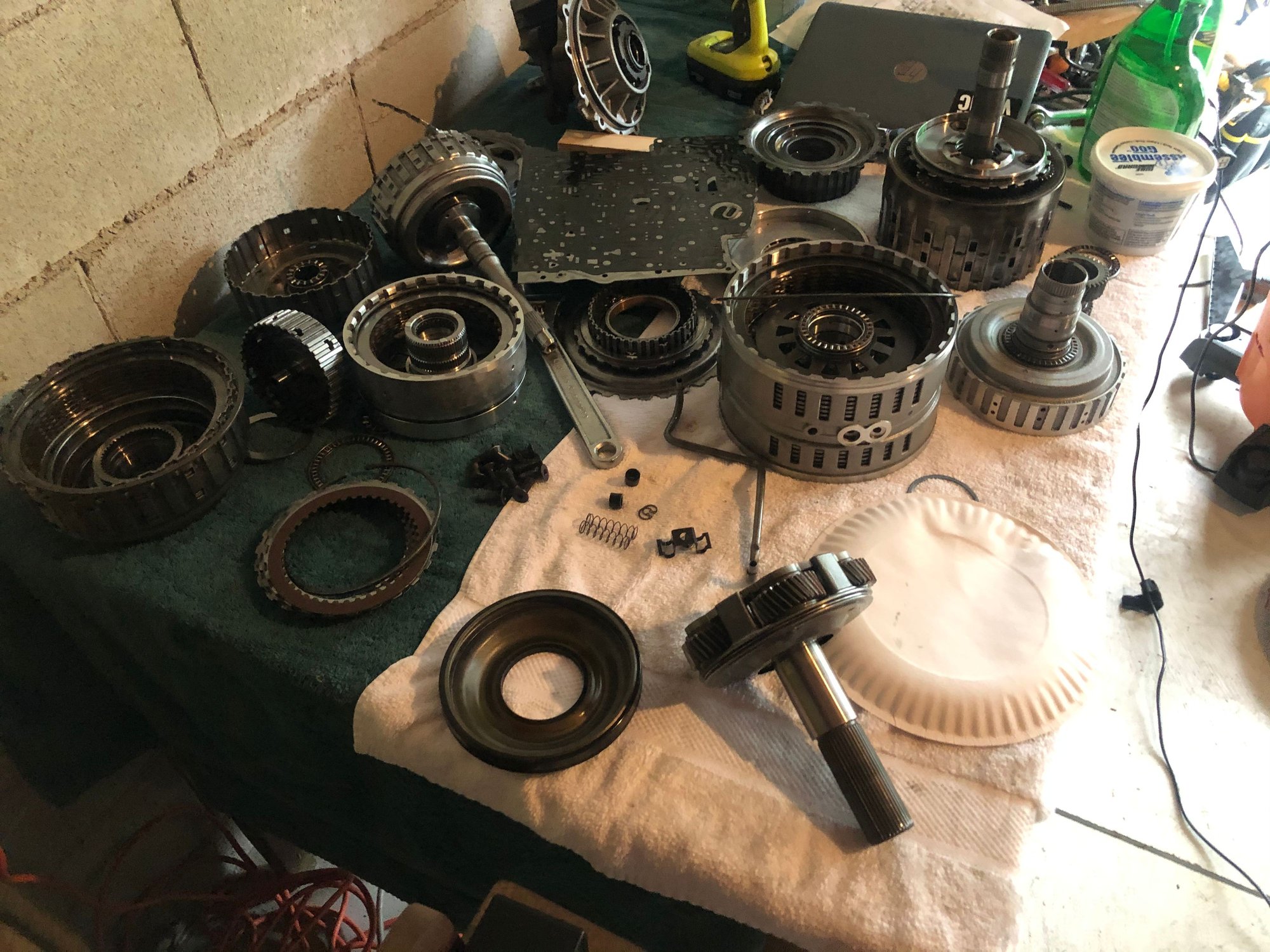

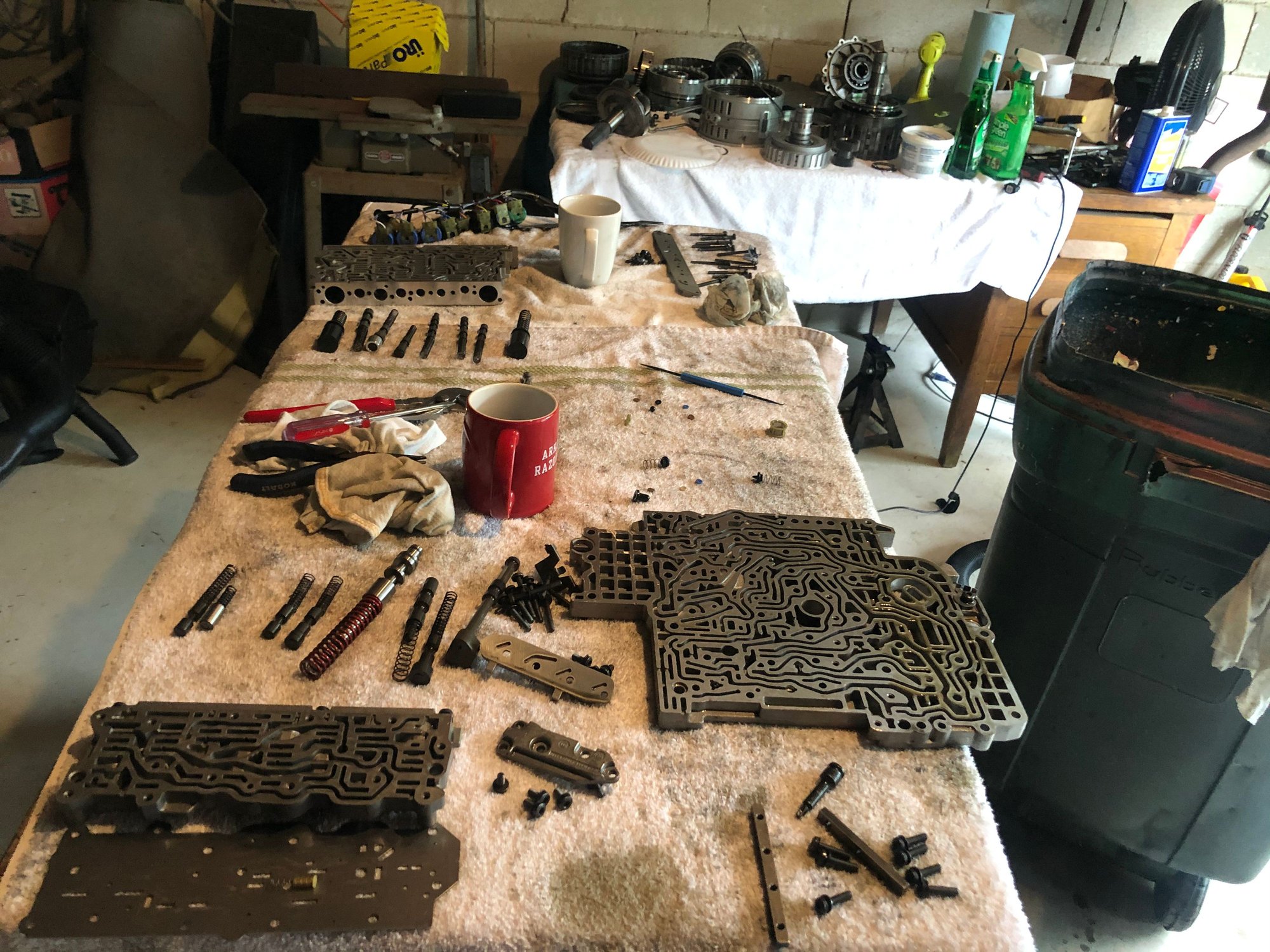

well I figured out the problem. Transmission needed a rebuild. I dropped it down and found a blown A and B clutch see damage in photos. I decided to replace the lower front valve body due to wear, and used the updated ZF main pressure valve. Also replace all O rings inside the transmission along with the F piston which was slightly worn. Anyone scared of this job, really it isn’t as scary as it sounds just watch all the YouTube videos by Gary and also get the complete ZF manual and go slow. I made my own compression tools out of PVC pipes and C clamps. A bit clumsy but worked. I only replaced the A clutch pack. The others seemed fine (80K miles).
Be careful not to get these mixed up
Hub blown off of the B clutch
