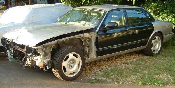

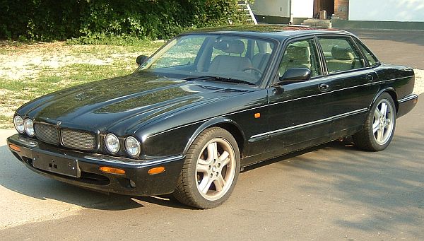

Thankfully now I've got full forum access, so here are the pics about my cars:
If you look at the pictures, you may ask, why the black one for donor instead of the silver, but that car has so many corroded points and problems, that I had to choose that way.

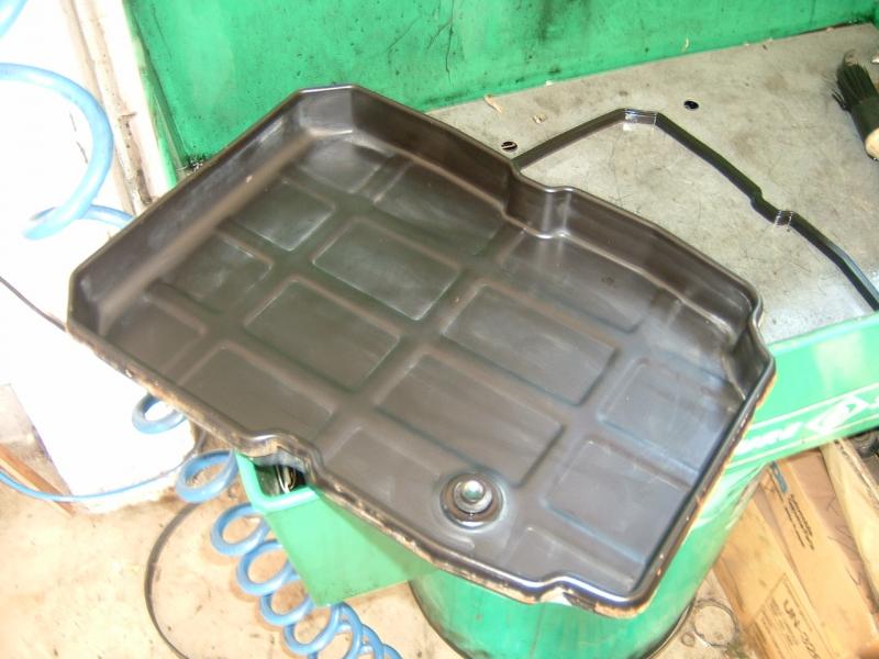

A drained out the oil of the trans in all of the two cars, and took off the pans for cleaning. Differences again. There were a 2x3 inches magnet grille at the bottom of the older (1998) car's pan, but the newer one has only magnetic drain screw in the pan. ???

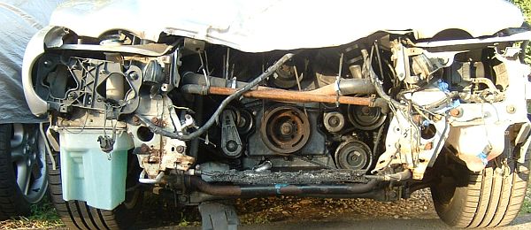

How are you getting on with the front end work? have you checked that the front chassis rails are straight and the subframe undamaged? If the airbags have deployed, it must have been a big shunt!

Fortunately the car met with the pillar between the two chassis rails, exactly in the middle of the front. The big thick (body colored) pipe between the rails has curved, but did not pull the rails end closer to each other, "only" the front end frame damaged (that is point welded to the rails). The stabilizer arm curved, and unfortunately the crossmember pipe (black) which is welded to the front of the subframe curved too. So I have to replace the front suspension subframe from one car to the other. I hope thats are all the same.
