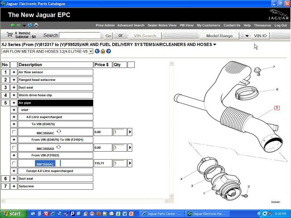

I looked the Air Pipe on the JEPC (Jaguar Electronic Parts Catalog).
Here is a jpeg file of the page (find your Vin# and get the associated part number):
This part should cost around $38 plus shipping -- if it is part# NNF3555AC (priced at jaguarmerriamparts.com).
Jim Lombardi

I think I found the right part.
Collision Catalog - 2000 - Jaguar - XJ
Engine, Air intake, Air pipe, From vin 834576, From vin 834576 - W/supercharger - W/supercharger
I don't have my JEPC yet. That was the only one listed for engines with a supercharger though
My vin ends with F15512

Originally Posted by jimlombardi
Hi Rick
Attachment 9443
Jim Lombardi
How snug should the duct seal fit on the end of the pipe? Mine seems to slide right off and it feels like the pipe itself is just laying on the top of the intake instead of snuggly fitting
