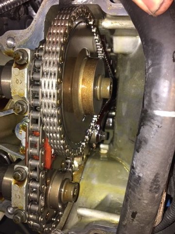

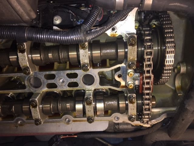

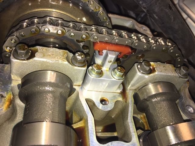

My car has been problem free for a couple of years and according to the engine number it came from the factory with metal timing gear. Today, after sitting for a week or so, it made some intermittent squeaking noises from the serpentine belt area. I've replaced all the bearings in the accessory belt area recently so the noise surprised me. It sounded like it could be the water pump, maybe; it's 9 years old. I had a backup water pump and gasket on the shelf so I figured I would go ahead and replace it; easy job on an X308. With the new water pump (and new coolant) it made the exact same noise.
I put the stethoscope on the cam covers again (I did it before and heard nothing abnormal). The passenger side bank sounded like the noise was coming from the inside!! I panicked. I pulled the cover off immediately expecting a scary scene. Nothing, All metal timing gear, no apparent damage, both chains snug. I snaked a camera down but could only see lower chain area partially. I didn't seen anything worrisome. The guides look brand new.
Any suggestions on what I'm experiencing?
