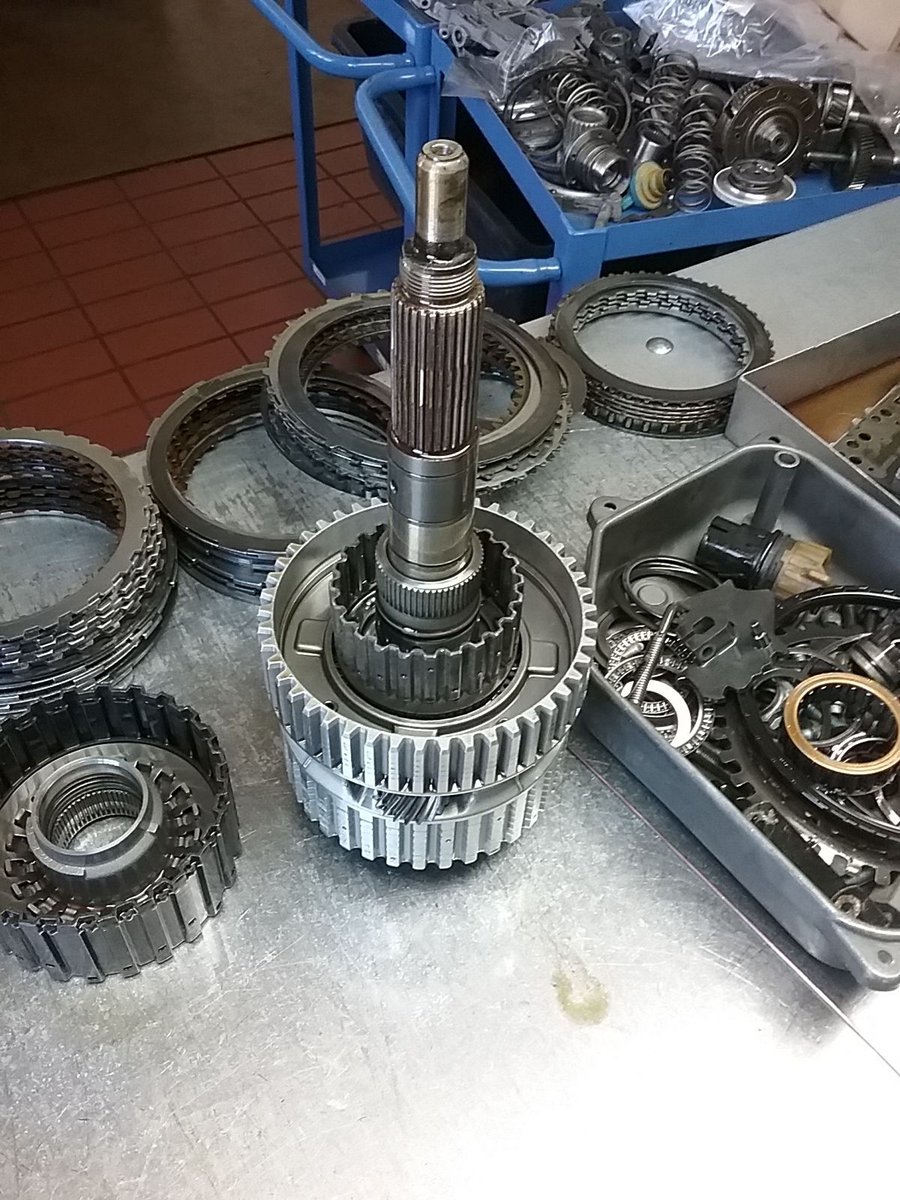

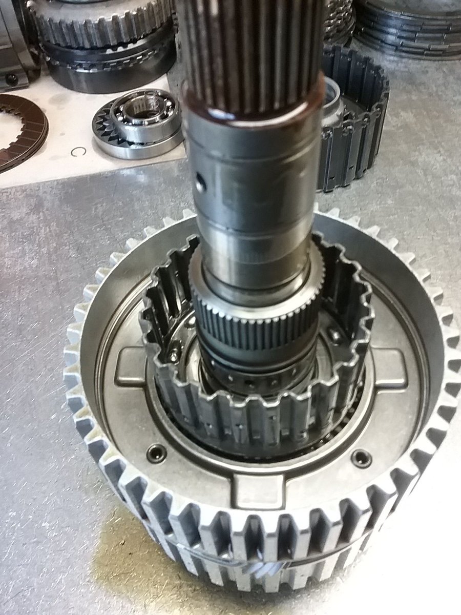

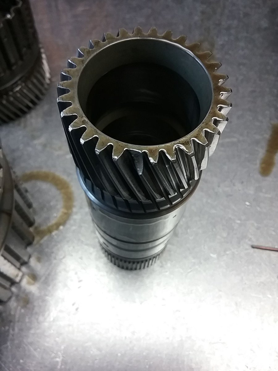

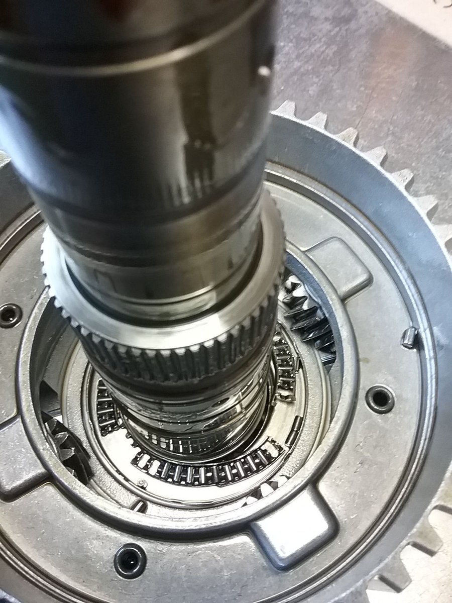

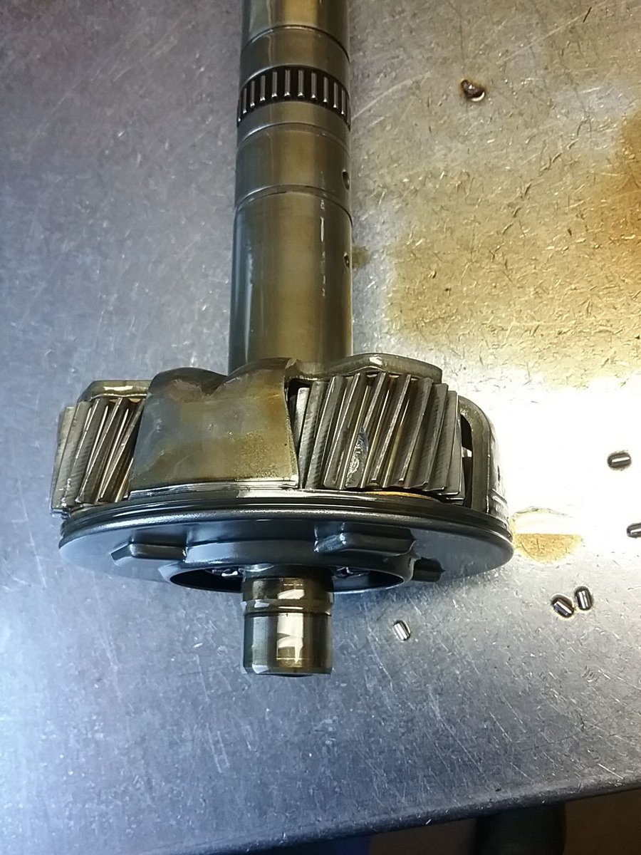

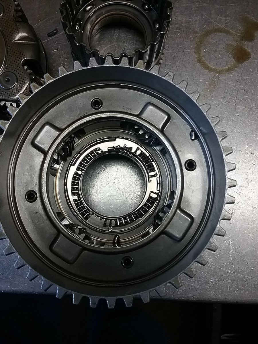

I brought the Jaguar to a Transmission Workshop. Bad News: Gearbox Failure because of broken bearings and a snapped Gear tooth.
I have attached some photos. A complete Revision was needed.

The shop did a total rebuild of the transmission. Funny thing is, it doesnt run differently than before but the noise is gone.
