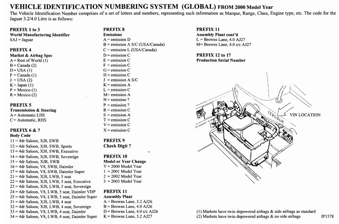

VIN does not tell you paint or trim color..............here is a VIN decoder for Jaguar X308 year 2000 onward.

Old Feb 8, 2021 | 01:05 PM
Likes: 17,005
Stephen,
The UK X308 has the Manufacturer Label on the body front upper crossmember. Unfortunately the Paint and Trim codes are not recorded elsewhere on the vehicle.
The full specifications were available for anyone to see on Jaguar TOPIx until late last year but JLR has now blocked this information in response to Data Protection Regulations. Although the VIN does not include this information, any Jaguar Dealer can look it up for you from the VIN.
