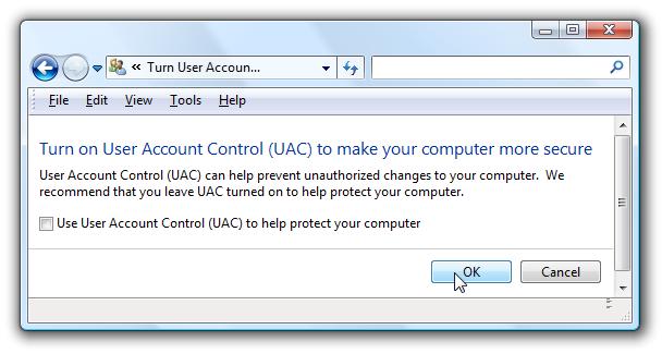

Open up Control Panel, and type in “UAC” into the search box. You’ll see a link for “Turn User Account Control (UAC) on or off”:
On the next screen you should uncheck the box for “Use User Account Control (UAC)”, and then click on the OK button.
You’ll need to reboot your computer before the changes take effect, but you should be all done with annoying prompts.

At this point you should turn the Vista User Account Control (UAC) back on by enabling it. See instruction at the beginning of this thread. You click on the box. It puts a checkmark in the box for “Use User Account Control (UAC)”, and then click on the OK button
